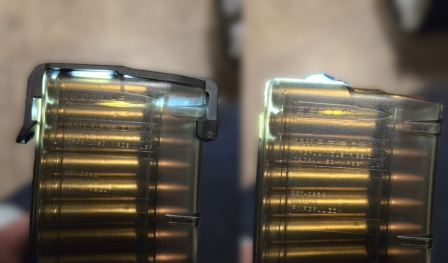

The covers work by pushing down the topmost round further into the magazine just enough so that there's no pressure being exerted on the feed lips. This photo is a collage of a 30-round TMag with the cover on and off. The graphics molded into the side of the mag can be used as a reference to see that downward shift of the rounds. The crescent shape above the feed lips in the right-hand side photo is the flashlight bezel.
I wouldn't be concerned with the feed lips spreading when locking a loaded PMag in the magazine well as long as it's under a closed bolt carrier group. The BCG will basically do the same thing as the cover in that the pressure on the feed lips will be relieved when the topmost round is compressed against the underside of the BCG.
