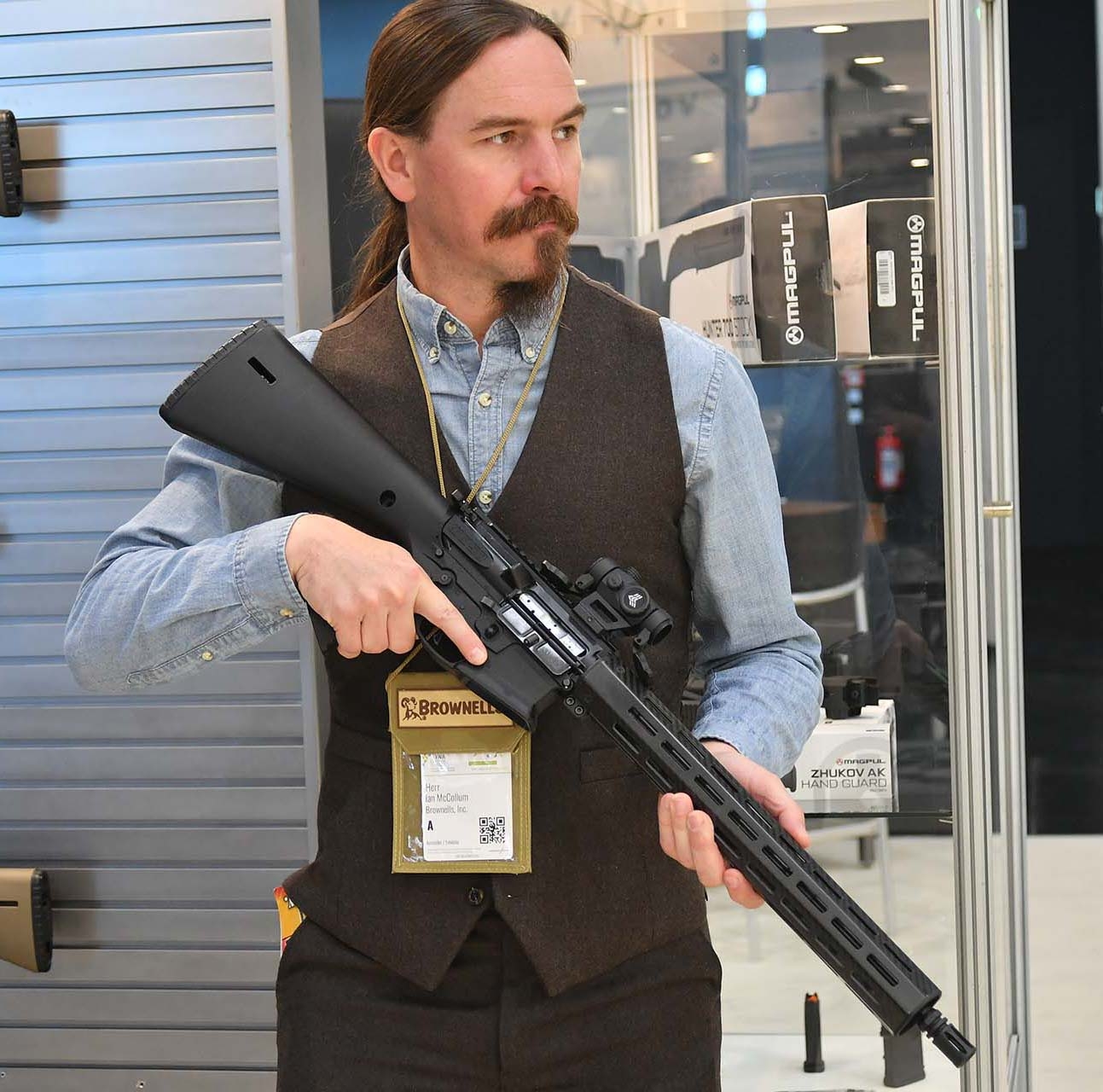

Ian McCollum from Forgotten Weapons embarked on a similar journey a few years ago, looking to make a basic, lightweight, all-around AR15 (albeit not a SBR), and ended up with the "What Would Stoner Do" Carbine, which was then licensed and produced by KE Arms and distributed through Brownells.
It ended up at right around 5 pounds, with most of the weight savings coming from stuff like a polymer lower with a pencil barrel and carbon fiber handguard, but they also eliminated extraneous stuff like the forward assist to save further ounces.

Rogue, thanks for posting what Ian McCollum came up with. Incidentally, I embarked on the same project and have at least got the upper somewhat figured out. I went with an upper that had a forward assist because that's what was available to me, but may eventually swap it out for one that does not. I also went with a 16" pencil barrel and a carbon fiber handguard, but mine is a PRI octagonal a friend bought for a project, didn't use, and gave me a great deal on. Don't have the lower together yet, and the plan was to go with a standard lower, but now I'm curious what else is out there. That KE looks tempting, especially for the price, but I have a Reptilia RECC-E I snagged as soon as they were available. It's like UBR but half the weight of the Gen 1 I had on my first carbine. I'm under no illusions that it will be anywhere as tough.
I need to weigh it, but with a 3-10 Weaver in an Aero lightweight offset mount and an MFT Battlelink stock, it's very light, and balances just forward of the receiver.
