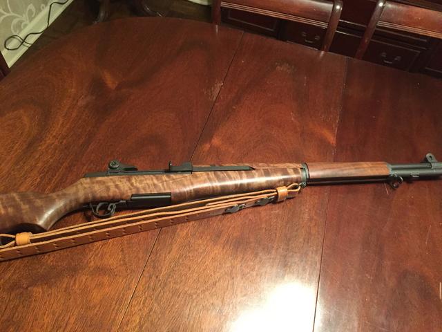

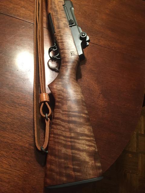

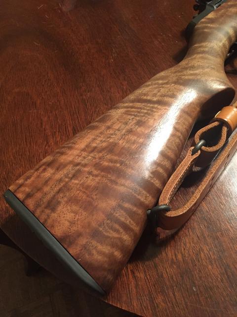

Dean (RIP) at DGR did mine. I got a "woodless" Dane from the CMP and some other new parts I sent him. He did it in the Bastogne hybrid walnut he had at the time, NM trigger job, and put in the white spacer for the magazine. Beautiful gun and the pride of my collection.
March 28, 2019, 09:08 PM
David Lee
dusty3030, it looks like water stained fiddle back. I love seeing the Garand in nice wood. What a beauty. To the OP, my friend Brian used to convert the M1 to feed from M14 magazines. He was good at building those.
