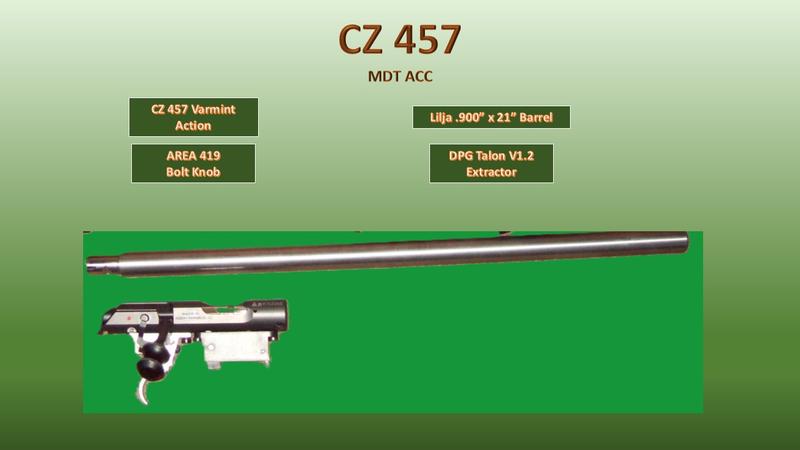

So as not to keep stepping on Todd's thread, I figured I'd start a new one to follow the build progress of my new benchrest rifle.
Step 1... (all I could afford this month Big Grin )

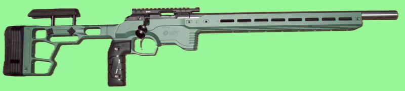

OK...step 2...(yea, I know but my financial month starts on the 4th Wednesday)

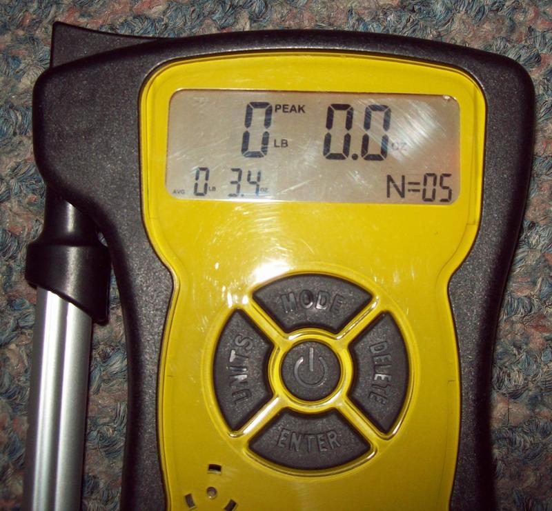

I can’t wait to see how she shoots.

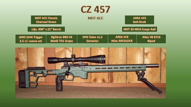

Step 3…
1. Polish bolt wear surfaces and channel
2. Install DPG Talon extractor
3. Install JARD trigger
4. Deburr barrel lugs and polish chamber face
5. Install Lilja barrel - headspace set @ 0.040
6. Install MDT 20 MOA scope rail
7. Install barreled action in MDT ACC chassis
Scope, ARCALOCK clamp, and Bipod should be here tomorrow and we’ll finish up.
Thought I would try a little lighter trigger, too.
____________
Pace
Posts: 1698 | Location: in the PA woods | Registered: March 11, 2013Reply With QuoteReport This Post
And we’re done…
Great timing since KSS just got new lots of Eley. I have a few different lots of Tenex and Match coming in as I’m getting a little low.
Looks like rain the rest of the week so I’ll lot test when I can. Should be an interesting exercise. My other Lilja likes Match at around 1060 fps. Would be very convenient if this one does too. Not pleased that it went up another dollar a box from last year though.

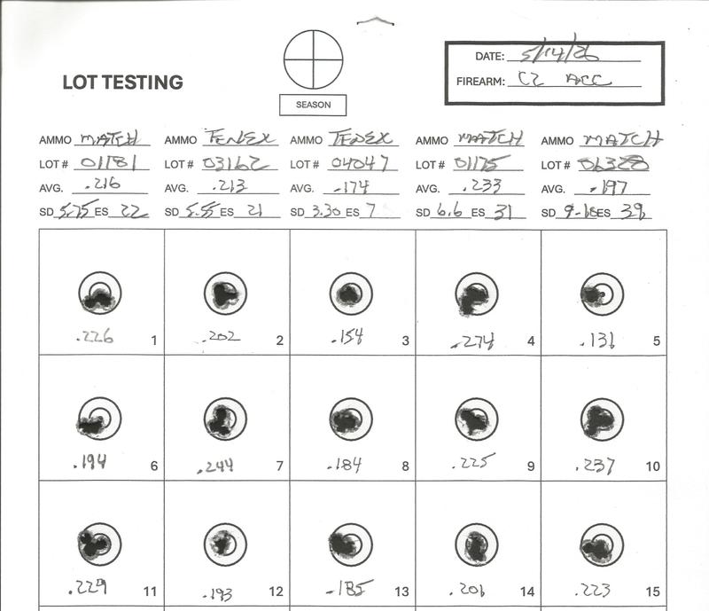

Finally got a chance to do this.
OK then…got some random lots from KSS and a couple of test bricks from Whidden. After a day of testing everything yesterday, I narrowed it down to the 5 best lots.
I’ll shoot 3 – 5 shot groups of each to pick the best. (More if the wind starts being a pest.) The leftovers will be for plinking and practice. Average group size, standard deviation, and extreme spread used to determine bulk order. And the winner …
Tenex lot # 04047 it is. Case on the way. (couldn’t be the cheaper stuff) Hopefully will last a few years, although I’m thinking of jumping into benchrest silhouette too, so maybe not.
Guess I'll have to keep the gun. She shoots pretty good. And the trigger is outstanding. Maybe I'll shoot that 25/25 this year. Big Grin
