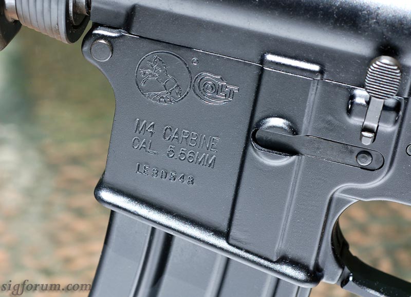

I put this one together ten years ago, all Colt. Complete Colt upper including Colt OEM BCG and charging handle. LE6921CK 14.5" with an AAC Blackout non-mount FH pinned and welded to bring it to legal length.
Colt LE6920MP complete lower (minus buttstock) purchased off Gun Broker. Staked receiver extension.
Colt OEM waffle stock purchased from Brownells.
Colt OEM carry handle purchased from Brownells
The lower had the usual not-so-great trigger of Colt ARs of this era, so I installed an ALG QMS which is indistinguishable externally from the Colt trigger. Magpul MOE grip and Magpul aluminum trigger guard.
GG&G side sling adapter for the buttstock. I removed the Colt front side sling adapter because I've always found it a bit clunky, and installed a Colt OEM front sling swivel.
I've set this one back and left it unfired. (The Chinese bipod was used for photo purposes only)

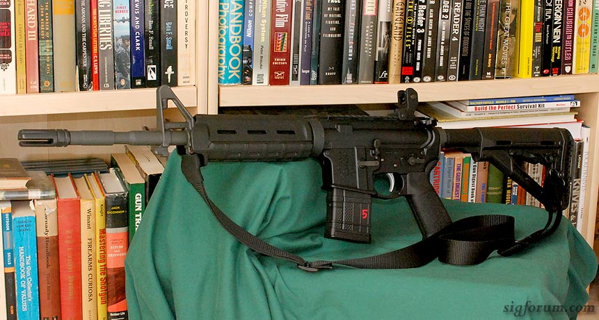

I've got one I built around another Colt 14.5" M4 barrel, again P&W with AAC Blackout. Colt Upper receiver and receiver extension and associated parts. All Colt small lower parts. Colt OEM action spring and OEM H2 buffer.
This one looks a bit different now than in the pic, with a Daniel Defense A1.5 rear sight replacing the Troy, which had some problems. In the photo, the rifle wears an ALG ACT trigger but it now has a sweet Geissele SSA installed. Originally, this was built on a Noveske lower, which has been re-tasked, and the rifle now wears a perfectly fine Anderson Manufacturing lower. Magpul furniture, and the grip has been updated from the MOE to the MOE+. The sling has been replaced with my standard Blue Force Gear VCAS. A really sweet-handling carbine.
