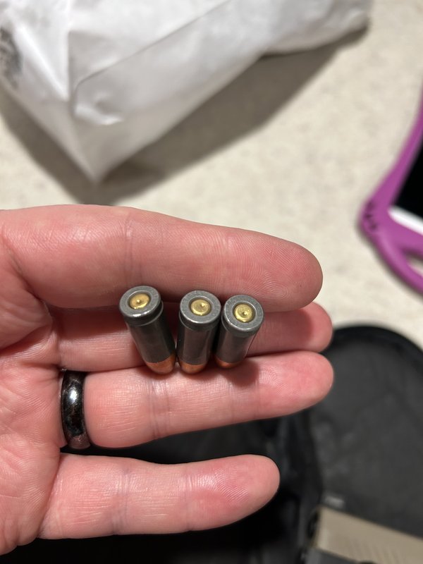

First, the Norsso barrel I got consistently prevents the slide from returning to battery.
Works fine with the factory barrels.
Second,
Gonna clean, lube well, and see if I can break it in.
Otherwise I’ll contact Norsso, I’ll also try it in the factory slide next time.
Overall I’m not disappointed as this is a project fun, but the kicker was the Holosun tightened to factory specs also came loose! Frustrating but gives me a reason to go back Friday or tomorrow.
Wife’s last 9 rounds (P322 ain’t reliable 10 in a row). Not bad for first time ever shooting.
About 16’ distance.

The FTRTB and the light strikes could be related...your headspace may well be off. I'd confirm that that barrel is properly fitted, or just hit the easy button and source a factory barrel.

Those failures to fire (seem to) have impacts that are significantly off center, in addition to being very light. Off center impacts can result in failures to fire, and of course so can light strikes.
I believe that if the slide wasn’t fully forward when the impacts occurred, that could be why they were off center.
If they were light strikes as well, I’m not sure if the slide’s not being fully forward could cause/contribute to that, but maybe.
Excessive headspace is another possibility for light strikes. As a quick check for a possible problem, drop some cartridges into the barrels after they’re removed from the slide. The base of case should be flush with the barrel hood extension that contacts the breech face of the slide. If the case sits farther into the chamber, then either the headspace of the barrel is excessive or the cases of the cartridges are too short. If you see that problem, try different cartridges to ensure it’s not a case problem.

Sigfreund, definitely related as I’m 300 rounds into this lot and it’s working fine with factory barrel and other 9mm firearms.
I tried the barrel on different slides, different RSAs. Tried factory on the same slides and RSAs, and the only constant I see is that everything else works fine in ANY combination and this barrel has the same problem in EVERY configuration.
I’m not bashing or anything at this point, just pointing out what I’ve seen. Norsso has been very responsive so I don’t doubt they’ll fix it.
