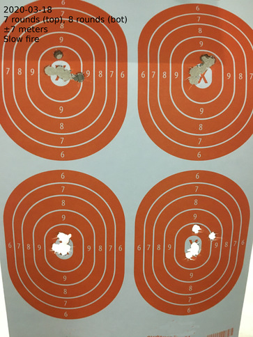

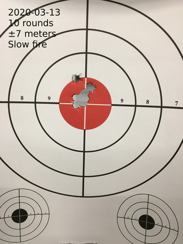

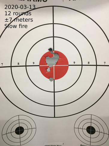

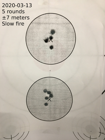

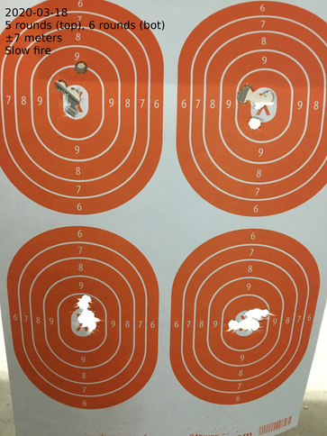

Here are my targets, in the order I shot them. Mind you: I've been doing a lot of dry-firing the last three weeks, but this was my first time to the range in maybe a year.
Here I was just shooting to break the gun in. Not trying particularly hard.
For reference: These circles are 4 inch diameter.
I really need to get to the range more often.
