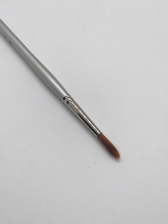

I've always used small acid brushes to apply grease, ( Slide Glide lite ) to all of my semiautomatic firearms.
On Glocks, I brush a thin coat across the top and bottom of the barrel, ( in the same areas one typically sees barrel 'smilies' on SIGs, for example ) then the four metal rails in the frame that the slide rides on. I also put a little within the slide rails as well.
Reassemble, rack it several times, wipe off any excess.
A bit over kill for a Glock? Possibly... but it's been working fine for over a decade.

Grease in squeeze tubes is easy to place precisely. You can do it with a horse syringe if you don't have a dedicated applicator. I've also applied it with the tip of a small screw driver, and the end of a q-tip with the cotton portion slipped off.

Glocks- I apply a little bit to the 4 points on the frame where it contacts with the slide. I also put a little drop of oil in the rails and coat the rails with a small brush. Other Autos, Ill dab a bit along the rails, enough that when I cycle the slide, the grease should be covering the rails.
The grease I usually apply with my finger or the nozzle of a big syringe that I'll pack with grease. I'll admit, if you can find a small container with a screw on cap, that is much easier than a big syringe. Apply it with a small brush or something. Rack the slide a few times, wipe off any excess (usually collects along the rear of the slide & frame).
I've been using Hi-Temp wheel bearing grease and 30W oil for probably a decade now. No problems with any of my guns; from desert, to snowy -20F days here in Chicago, rain, mud, dirt... Nothing against Slide-Glide, and I know many of the "pros" use it, but I'm not paying those prices.
Remember, the more grease / oil you apply, the more that it will attract dirt, dust, grime, carbon, lint... you don't have to coat it like you're frosting a cake.
