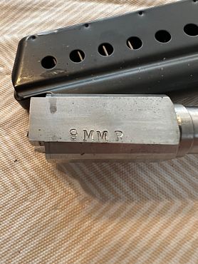

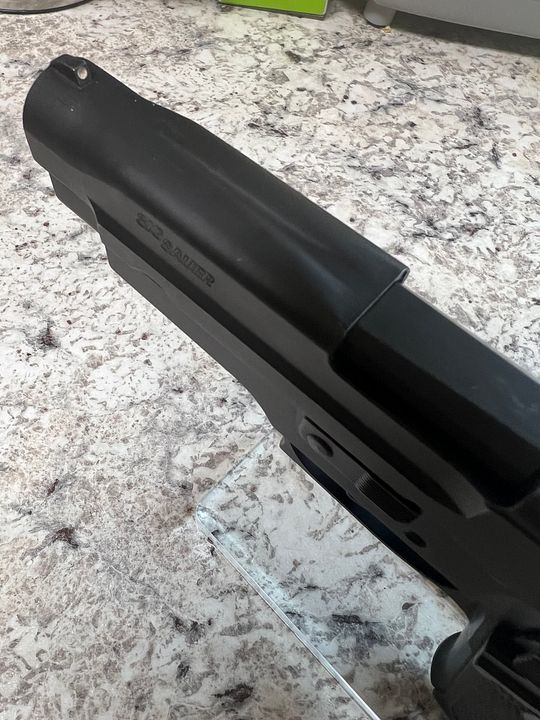

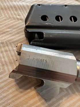

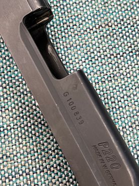

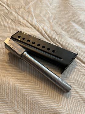

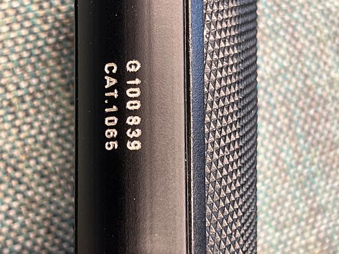

I have come across what appears to be a lovingly molested Italian market P220. The modifications seem to be for enhancing the target shooting ability. It has presented a lot of clues. Some of which are hard to answer. The serial # is G 100 839. The front of the grip is marked with the serial over “CAT 1065” all in the white. The CAT number would indicate it was imported into Italy as a 7.65mm pistol. It had been converted to 9X19mm with a J Peters after market barrel. Barrel is 9 cm long and is in the white. Stock barrel would have been 7.5 cm. The Peters barrel may have needed additional fitting. The action was very tight with it in place. I have temporally replaced it with a stock 9mm barrel, while hoping to find a 7.65 barrel. (Hey a fella can always hope.)

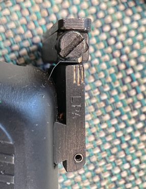

The rear sight has been replaced with an IPA Italian made target sight. The front sight remains stock. It was proofed in 1980 and the chin bottom is stamped “JA”. There are no import marks on the pistol. Magazine is unmarked large dove tail.
I have always wondered about the background of these pistols. Is any part of them left over from the very early days of commercial P220 production? The slide is a pinch nose folded slide with type 2 side milling but the top is not milled. I have seen this style slide on other weapons I the 1978-1980 time frame, so it fits with the 1980 proof date. The markings on the front of the frame grip are all in the white indicating that they were stamped after the finish was applied. Not having the original barrel, I can’t know its time origin.
All of the above leads me to believe that the only thing left over from 1976 was the serial # itself. This is total a guess. I welcome all thoughts and evidence.

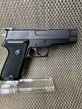

Can you please post a photo of the entire pistol?

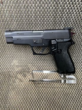

September 15, 2023, 01:38 PM
Udo
My ring light just blew up so I had to improvise.
[/URL]
[/URL]
[/URL]
[/URL]
[/URL]
September 16, 2023, 04:29 PM
p220cop
Very nice looking pistol! Rare breed with the transitional slide contours.

Both my 220 and 229 Sig Sport models had the LPA adjustable sight from the factory. So even if customer installed, they are found on other P220s.

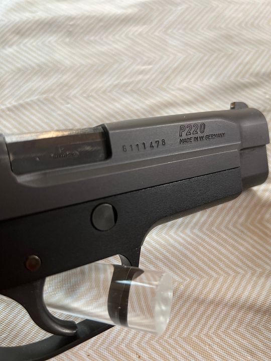

[/URL]
The 7.65
[/URL]
A 1978 pistol

https://www.lpasights.com/en/contatti/

You've seen LPAs here often, over the years. I believe all Sport models used them and I think the X series guns sights were made by LPA. They offer a Bomar style sight for 1911. A near copy.
