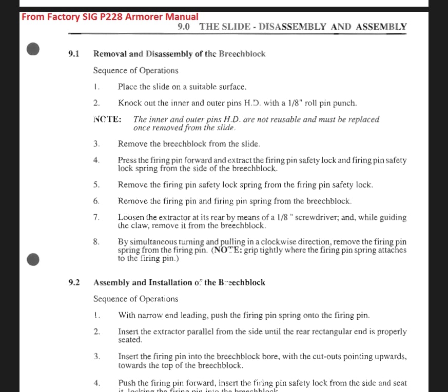

In the sig armorers class they just reused the roll pins (this was during the time of folded slides) as they were just class guns but they said the pins would last multiple diaassembly/reassembly and still work.
Sure, "still work", but they wouldn't recommend, in writing, to reuse those roll pins, once the slide is completely disassembled. The recommendation is to always replace them.

It wasn't a recommendation, I just said what they did in the class with class guns, mostly to say that the sig parts seem pretty tough

When I took the armors course we disassembled the guns put all the parts in a bin in the center of the table and later had to grab the parts we needed from the bin. Not a chance in the world these guns were ever going to be shot. Based on personal experience of shooting a folded slide gun competitively many many years ago the parts you need are the recoil spring, the roll pins (most common problem), the firing pin and the extractor. This over roughly 100K rounds of competitive shooting at that time.
