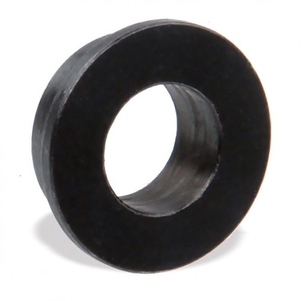

I have two Glock 21 Gen 4s, one of which I am leaving stock, and the other of which I want to convert to a .45 Super.
The problem is, finding higher power Gen 4 springs in the weight I want is difficult. Gen 3 springs are easy to come by.
Has anyone used a RECOIL ASSEMBLY ADAPTER RING FOR GEN4 GLOCKS that allows the use of Gen 3 spring.
Or have used the Jager Gen 4 Captured Hardened Steel Guide Rods.
Any thought or opinions, or alternatives, would be appreciated.

I have a Jager RSA for my Gen 4 G20
Good piece of kit.
To convert the Gen 4 to use the Gen 3 un-captured RSA I would recommend finding an adapter with a "spring pocket" machined into the "spring side" of the adapter.
I have one that does not have the pocket and it is a pain with heavier springs.
This the one I should have bought...
https://www.blacklistind.com/p...t/guide-rod-adapter/
Not sure if it takes ISMI or Wolff springs.
You'll want to verify.

I use the ring adapter on my gen4 glock19 to use a gen3 style spring setup. No issues. On takedown it can obviously fall out but that’s not really an issue.
I use an adapter that I bought from Lonewolf. I bought a 24# recoil spring and a tungsten recoil rod and the adapter. So far , it's been 100% in my Glock 21. Underwood 120 grain external hollow point supposed to be going at 1600fps. It definitely has more recoil than a +p. I'm not fond of recoil but this is certainly acceptable in my Glock 21.

For reference, the .460 Rowland kit I ordered ships with a 24# spring and an adapter for gen3 to gen4.
