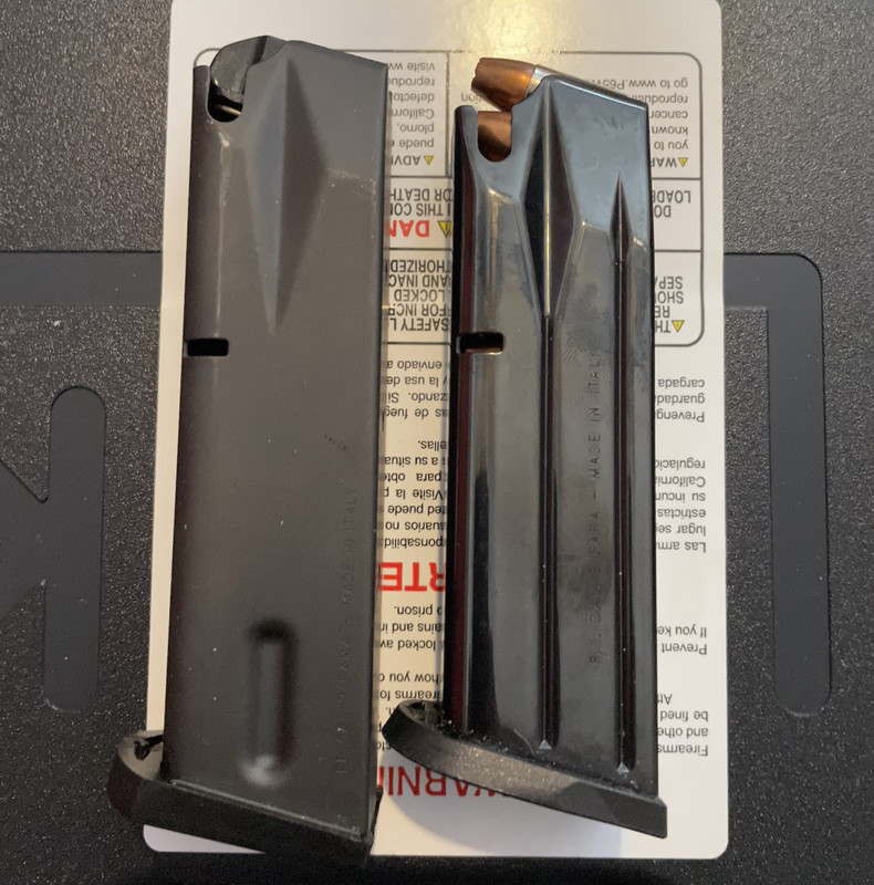

I have a CX4 in .40 that came with 2 mags. I've lost or miss placed the paper work that came with it. I don't own either a PX4 or 92 Beretta and would like to know what the mags are. How can you tell by looking at them?
Jim
For real?
Picture of Chowser
Oem mags. 92 on left. Px4 compact on right. Full size will look similar.
Not compatible. I have a full size PX4 mag somewhere, I will look for it if the op hasn’t posted a pic of his mag soon. The 92 mag goes in to my px4cc but doesn’t lock.

Picture of Jimbo54
Thanks Chowser, that's a big help.
