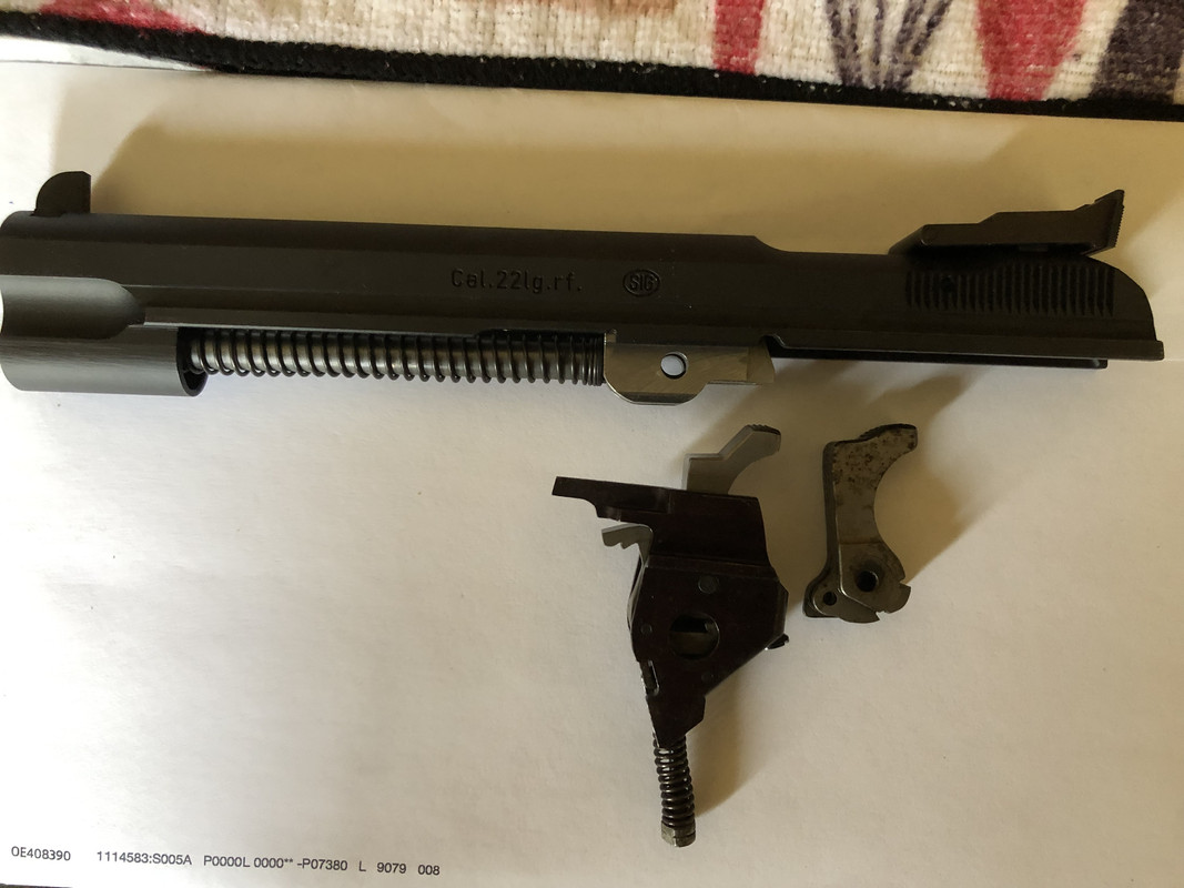

For those who are not aware, when using a P210 .22lr conversion with an adjustable rear sight you must have a "Sport Hammer" installed. A regular hammer will smack into the bottom of the rear sight blade. Refer to the picture below.

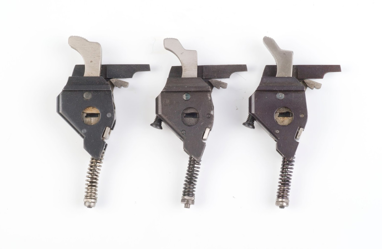

The hammer pack on the left has a standard hammer installed, the middle one has a Sport Hammer, and the right most hammer pack is for a P210 National Match.

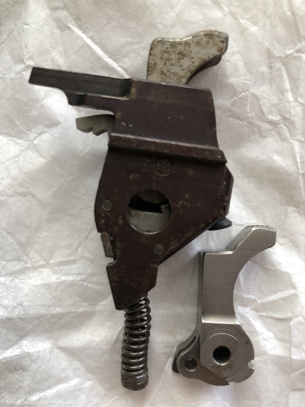

Here is my hammer pack with the yet to be installed Sport Hammer on the lower right.

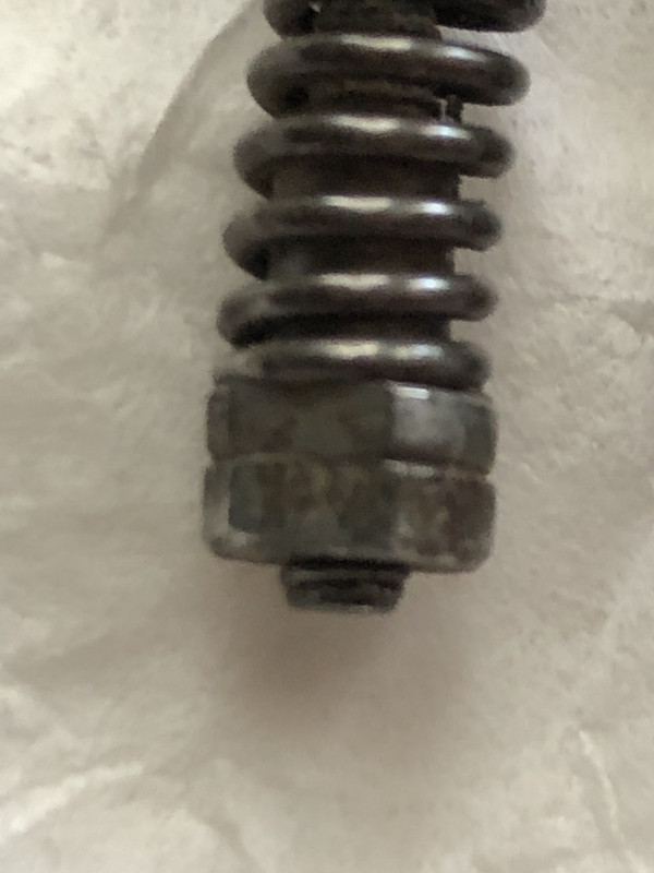

To proceed with the nut removal you will need a pair of very tiny and thin face open end wrenches. On my hammer pack the nut was rock solidly attached to the spring guide.
The spring guide must be held solidly while the lock nut is removed. Both the spring guide and lock nut have right hand threads.

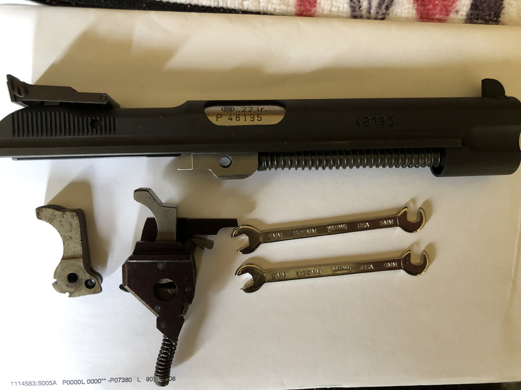

I was told the lock nut and spring guide had 5mm heads and was able to find an eBay seller offering what I needed.
The wrenches arrived with today's mail. Following the above video and using the wrenches I was able to successfully install the Sport Hammer.
