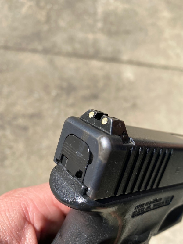

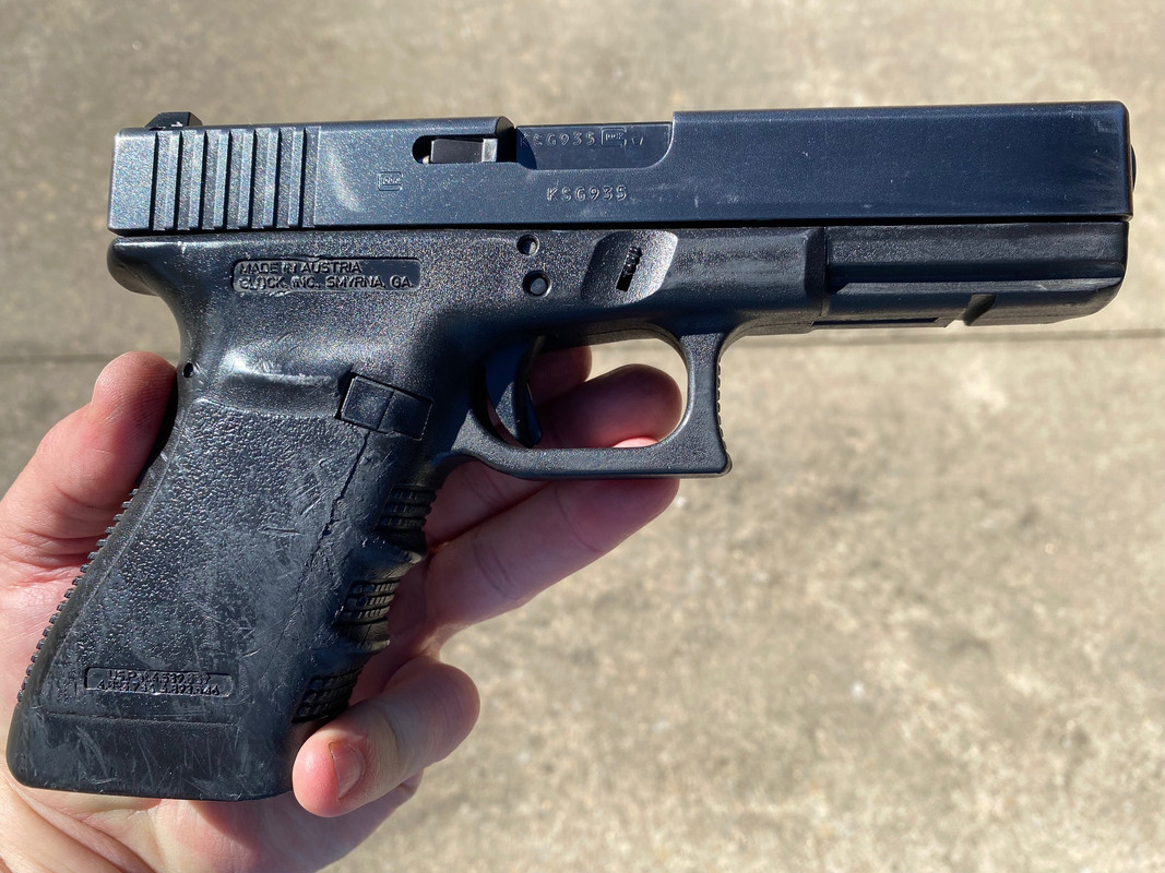

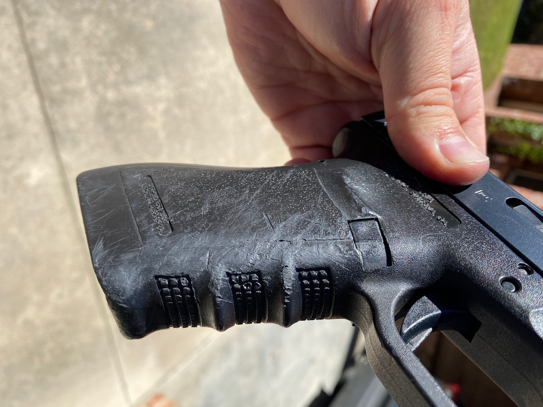

In a brief revival of this thread, I wanted to post some pics of the most abused duty weapon I've ever seen in my career...and it runs like a top.
This poor G21 sure has seen better days. It's been one hell of an abused duty weapon. The pics alone tell the story. If I were a betting man, I believe the wear on this duty handgun is actually "road rash" damage. Heaven only knows how it got there.
This handgun fired 1000 rounds of Speer Lawman in this condition without any malfunctions during range week in late September, 2021. The G21 is just simply a superb handgun.
At the academy where I teach, this Gen 3 G21 is actually issued to my squad leader by his agency. He's 22, so this G21 is likely older than him.
THE BAD NEWS
Rural sheriffs and chiefs in my state continue to issue duty weapons in this condition to their officers.
I felt so bad for my squad leader that I loaned him my Gen 3 G19 over a weekend (he was off duty) and took this G21 home, where I did an armorer's inspection and cleaning for him. I don't think it had ever been done. I've never seen a more filthy duty weapon. The G21 had no broken parts and passed the functions tests after reassembly, but it is tired. During the "shake test" to determine whether the firing pin assembly moves freely within the channel, the slide actually moved back and forward a little bit.

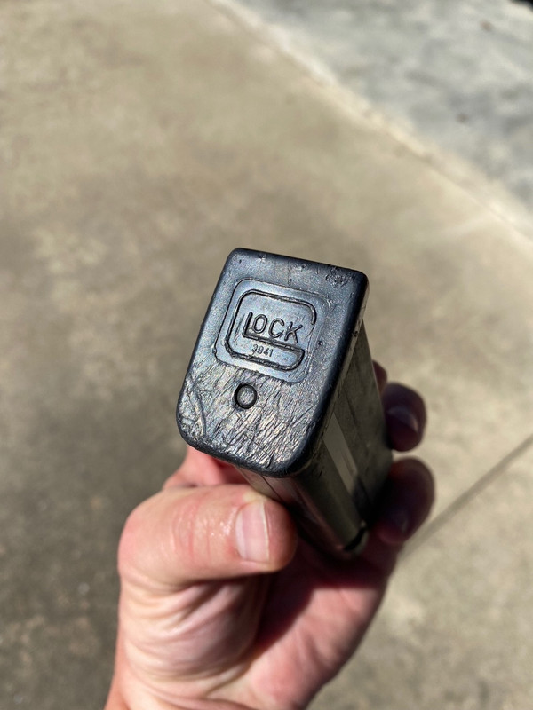

Two of the mags are Clinton era restricted. Still being issued. Shameful.
THE GOOD NEWS
I'm going to buy him 3 new magazines and replace his recoil spring guide rod before he graduates.
I suggested that he buy himself a new Gen 4 G21, but I think his rural department is going to buy and issue new ones. We'll see...
In 30 years of carrying Glocks, I've never seen this before. Real-deal Gen 3 tenifer actually worn away by seatbelt use, exposing the shiny metal underneath.

Meaning- replace the springs, firing pin, firing pin safety, extractor... A total of what, $40-45? And that gun will continue to go "BANG" every time you want it to.
Clinton era mags? If the slide still solidly locks back after the last round, you probably don't need the mag follower, just a new mag spring. I wouldn't hesitate to carry it with a new spring.
As for the finish: Hell, they pay extra now for that "battle warn" look! Wink. I wouldn't do anything to the slide, the frame, possibly stipple it. That's if you don't appreciate a "well warn" duty gun.

To clarify, the Tennifer isn’t worn away, the finish that is applied over it is gone. Tennifer is a treatment that penetrates the surface of the steel. We know the Tennifer is still there because that bare spot isn’t rusted.
That road rash on the frame sure tells a story, though. I see that and I can imagine an officer laying on their right side, wrestling someone on the ground in a street or parking lot.

Yes, sir. It's a piece of work!
It actually did pretty well during my parts inspection. The only parts needing to be replaced are the mag springs and recoil spring. The followers looked good. The mag springs extended only about a half inch past the bottom of the magazine! I should've taken a picture.
Being a duty weapon, I'm just going to get him the new mags for patrol and tell him to replace the springs in the old mags for the range.
When I was inspecting this pistol, one thing kept coming to my mind: I'm grateful that these young officers today have access to incredibly durable modern handguns like this Glock.

A couple of new magazines, a detailed strip for inspection and cleaning, and some good grip tape like Talon, and it would be back in a action.
