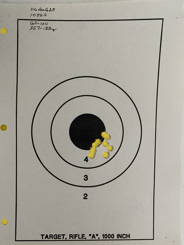

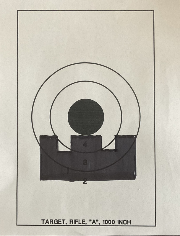

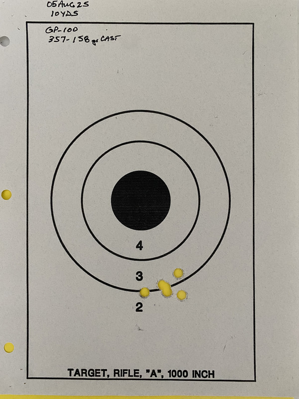

Got a 3” Ruger GP100 in 357mag (model 1715-fixed sights), secondhand but it still had the factory grease (dried) in it and didn’t appeared to have been shot.
Went to the range today and fixed that. So I’m shooting at 10 yards and my rounds are printing 2” below the target. I’m using the golfball on a tee hold on a target. 158grain factory ammo. The sight is 0.200” tall. (Benched shooting)
Can anyone measure their GP100 front sight and lemme know if this is just a standard height or should I file some off to get a POA=POI?
Or should I be using 125 grain ammo?
Or does anyone know if the factory sights are regulated at a different distance like 15 yds (and would that make a difference)?

Went back to the range today, at 15 yds (benched) it’s still low.
I measured the SP101 and its front sight is 0.173.
I shot some 125s and they were 8” low.
I’m gonna go back tomorrow and bring a file. Just swipe then shoot a 10 rnd group. Then do it again. Till I get it close.

I have a Smith 65 (fixed sight) and I ran the barrels muzzle to muzzle with a brass rod to line the bores up and the GP100 is much taller. The Smith prints POA with 158 ammo.
I also went to Dawson Precisions website where they have an easy front sight equation. You plug in the sight radius, the distance and how low/high your group is and they tell you what sight height to get. Turns out I need a .179 sight.
Went to the range, benched the gun and shot a group. About 2” low. I then began filing the top of the sight down a little at a time, using my digital caliper. Shot a group, did some trial and error and got the group to cutting the bull just where the POA is.
Took a measurement and it’s .179 (close enough)
Just finished cold bluing the bare sight.

It sounds like your Ruger's factory sights were set up for Center Hold sighting at between 15 and 25 yards. Using 6:00 sighting (guessing that's what "golfball on a tee" refers to), you would definitely print low.
At 15 yards POI would not be as low as 10, but it would still be low using that sight pic.
Switching to a lighter bullet will actually pull your groups down, as you found out. A lighter bullet will exit the barrel faster, i.e. earlier in the recoil cycle when the muzzle has not jumped as high.
Sounds like you fixed the problem by filing down the front sight, so good deal. Been there myself.

For clarity when I said goofball on a tee, I was referring to the center black ball of the target displayed, being just atop the front sight post. Much like your left picture if the whole of that target was black.
Kkina you may be right WRT the original sight settings. If Ruger had ever answered my inquiry I could ask them.
And now that you mention the “combat sighting” on your Sig, my duty gun(P226) was set up that way, wherever you blocked the front sight with the tritium vial(white dot) that was the impact. I hadnt thought of that until just now. It didn’t make much of a matter whe the B27 target has such a large “center” area to qual on
That's fine, same concept. Actually it makes sense, since I would have normally expected a larger offset at 10 yards, at least 3" worth.
