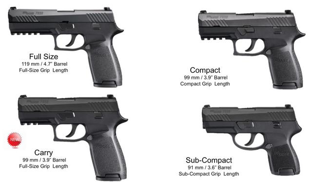

There are three sizes of the P320: full size, compact, and subcompact.
Pistols belonging to the full size include the P320F, X-5, and Legion X-5. Full size pistols using a full size grip module will take 17 round magazines. For those using an x-grip module, only current magazines wiht the square peg in the base plate, or older magazines with the dog ears trimmed, will fit. For those full size pistols using the mag well, the 21 round magazines fit best. With the funnel mag well, you can insert some magazines with certain baseplates, but they're harder to seat and extract (if needed); the 21 round magazine is tailor made for use with the funnel mag well.
The Compact pistols refers more to the slide/barrel length, than the grip module. Both the Carry and Compact models use the same slide/barrel length. Generally, Compact means a 15 round magazine, and Carry means a 17 round magazine (in 9mm). Given that the concept of the P320 is that other grip modules can be attached, there are a number of combinations one could assmeble with the various grip modules that Sig sells.
The Subcompact also refers to the slide length, rather than the grip frame. It's smaller than the compact, and a grip module may be attached which is smaller. The subcompact magazine is 12 rounds.
To muddy that a bit more, the new x-compact grim module is an x-grip made for the subcompact upper/slide assembly, but it takes the 15 round magazine. The same grip assembly may be placed on the compact slide. The x-compact pistol uses the subcompact slide, and x-compact grip.

This comparison made the rounds a few years ago when the P320 first arrived on the scene.
