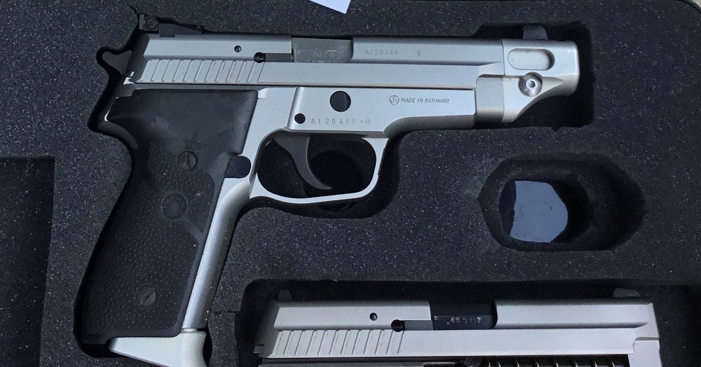

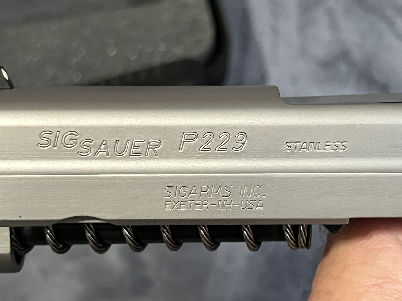

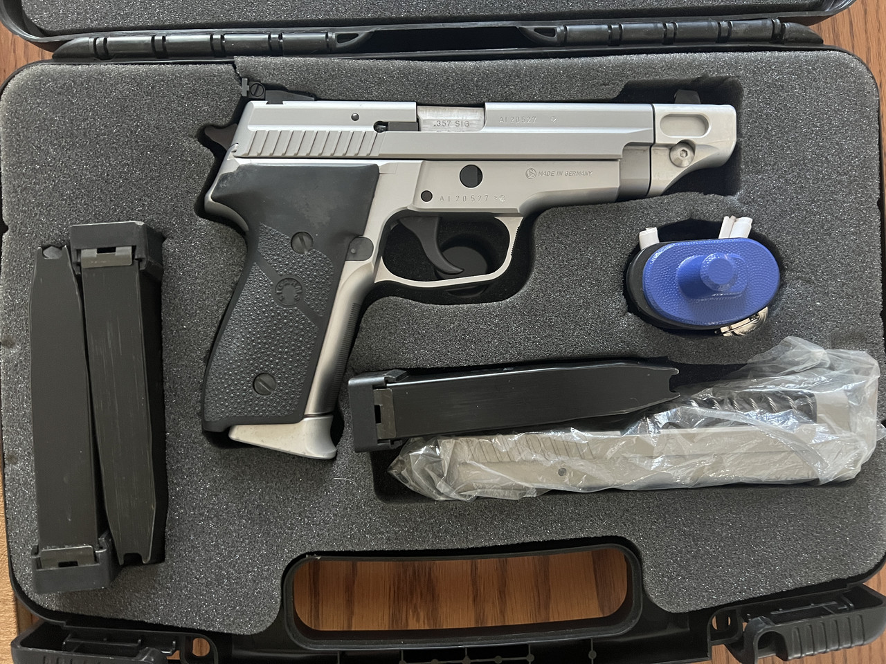

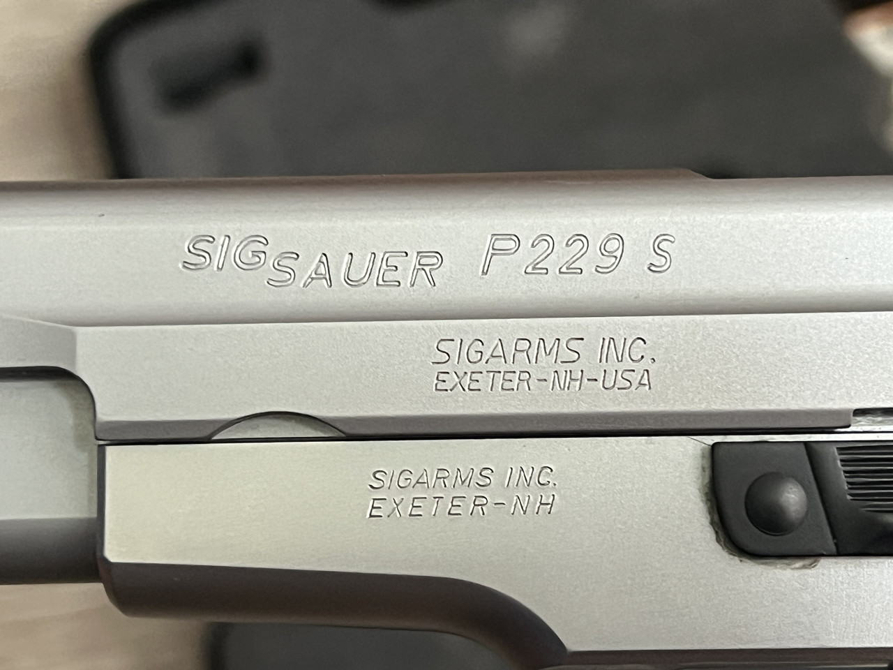

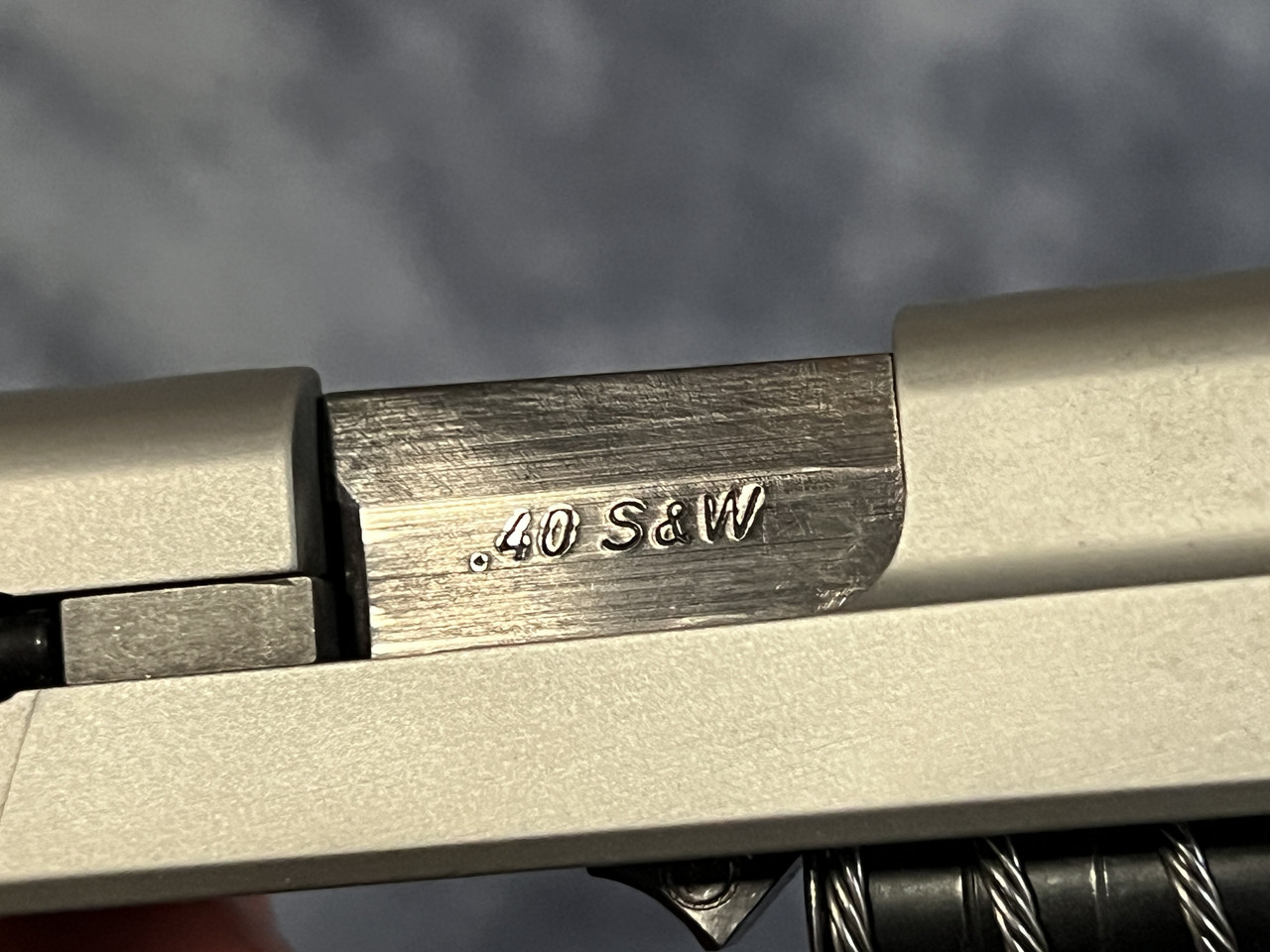

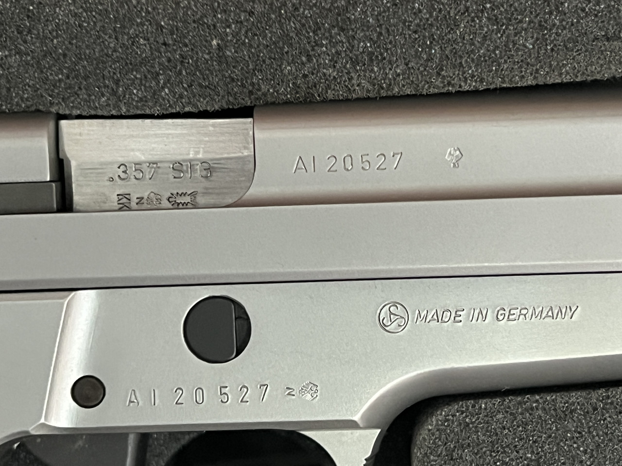

I am trying to document an unusual early P229 Sport, serial AI20527. The German receiver and P229 S Sport slide are both numbered AI20527 and the .357 SIG Sport assembly carries German proofing. The serial-matched original SIGARMS case, however, is labeled 229-40-SC / P229-40, ALL STEEL, WHITE, and the package contains a separate non-serialized Exeter-marked P229 Stainless .40 S&W upper.
The package also contains the German Sport compensator, German-made Sport magazine with aluminum base, German Sport instructions/tools, a U.S. SIGARMS manual dated 6/1/00, and a signed SIGARMS QC tag.

Here are the pics.
Posts: 5 | Registered: August 30, 2026Reply With QuoteReport This Post

Is this a Triple S/N pistol? Do only complete pistols get proof/date codes? If not, it's possible that the .357 SIG Barrel just happens to be assembled in the Serialized Slide and this 'could' be a .40 S&W P229 Sport. Those Barrels would have the same external dimensions and should be interchangeable. As such, the Upper Receiver could be assembled with either of those P229 Barrels.

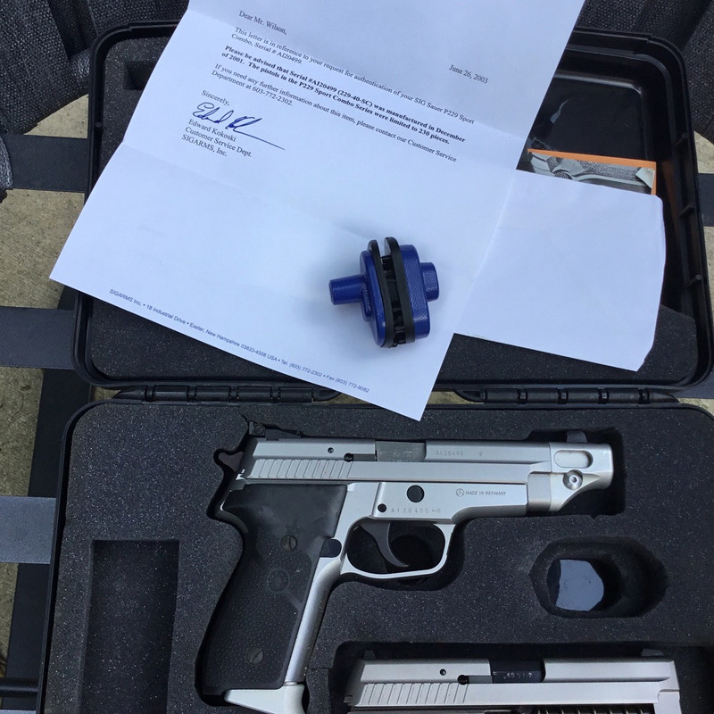

These are what I grabbed from the internet search and saved. Serial number AI20499 (only 28 from yours). Identical combo to yours, with document letter from SIG CS in NH. The .357 complete gun was German made and proofed in 1999 (KK). The .40 upper has no German proof marks/date code because it was made in NH. Also note that "P" inside the circle on the .40 barrel locking lug. That's another tell of a NH made product. The gun was imported by SIG NH, and they released the combo package in 2001 as noted in the letter. There is no reason to think that yours is not from this limited release.
Posts: 31625 | Location: TEXAS | Registered: September 04, 2008Reply With QuoteReport This Post
