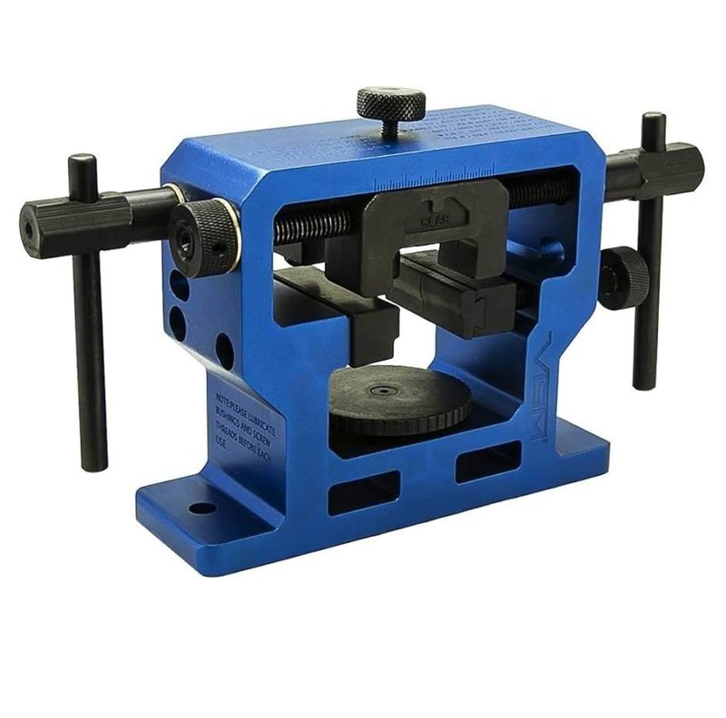

ok. i'm at a lost. i have tried 3 different sight pushers and resorted to hammer and punch and I think I am just going to break it if I continue.
Can someone recommend a sight pusher that actually works on these front sights? I even dug up this tiny red one and stuck it in a vise and it didn't budge.
i'm trying to replace the tall xray sight for a regular height ameriglo front sight. i was able to change the rear with no issue. the p365xl came with suppressor height sights which I don't want.
I sent an email in to Top Gun Supply to see if they have one since they're local to me.
thanks

I have a bunch of different sight pushers for Classic SIG, HK, Glock, and Wheeler Universal Armorer’s tool. The Wheeler tool has never let me down on even the toughest sights but you have to take a little time to set it up properly. I have also moved some stubborn sights with a vise, hammer, and punch. You can’t be afraid to whack the punch with a good blow to get them moving. You could also try a little heat with a heat gun first in case there is loctite on it.

I moved the sights from my Fuse over to my Shalotec 365 & added a set of XS F8 sights to the Fuse.
I almost couldn’t believe I was removing them correctly. Left to right.
But eventually they complied with my wishes.
The front sight was twice as difficult to remove than the rear.
I used my VISM universal as my sig sauer pusher is only for P-Series Sigs which were never this difficult to swap out.
I had an interesting time budging the front sight and the slide kept wanting to move.
Was not at all enjoyable but the new sights went in and adjusted with less issues.
*** video of this sight pusher in action
https://youtu.be/5WZvzZN2nvc?si=sTP8V8NXM-IRPqOX

Thanks everyone. That blue vism one is the one I have. I will try again and hope it doesn't snap off. I tried both directions. I'll grab my soldering iron and heat it up too I guess.
Wish me luck.

I was somehow able to get them off. lol. thanks everyone!
broke the ameriglo front sight. smh
got a better tool and installed the replacement mepro front sight. finally done with this p365.
