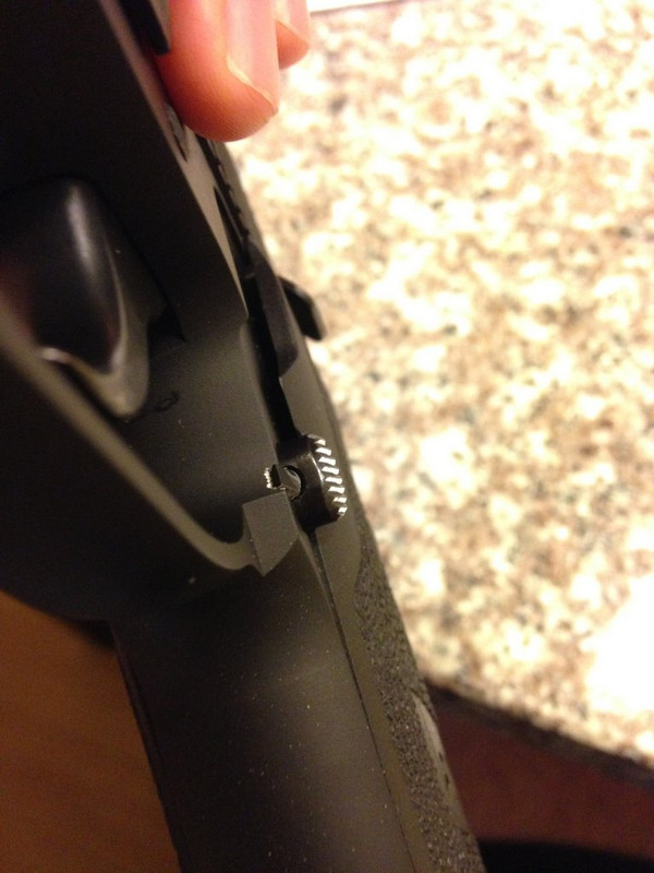

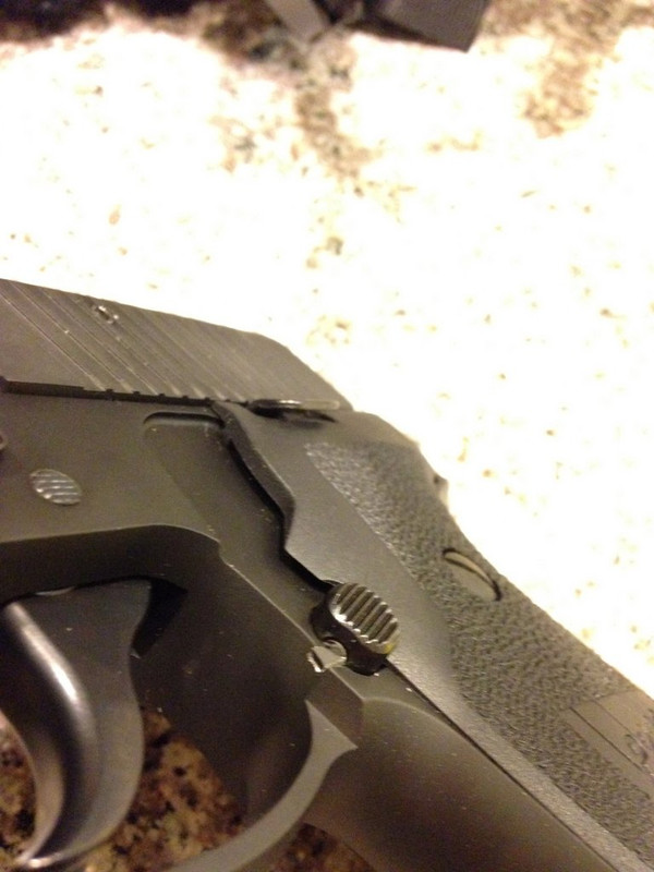

Looks like that the was a void In the aluminum. There is black anodizing where the should be aluminum.
Am I seeing that correctly?
Good question. Perhaps it's just the lighting, but you may be right.

That’s what I was thinking as well. To be fair, I have never taken out a P2xx magazine release.

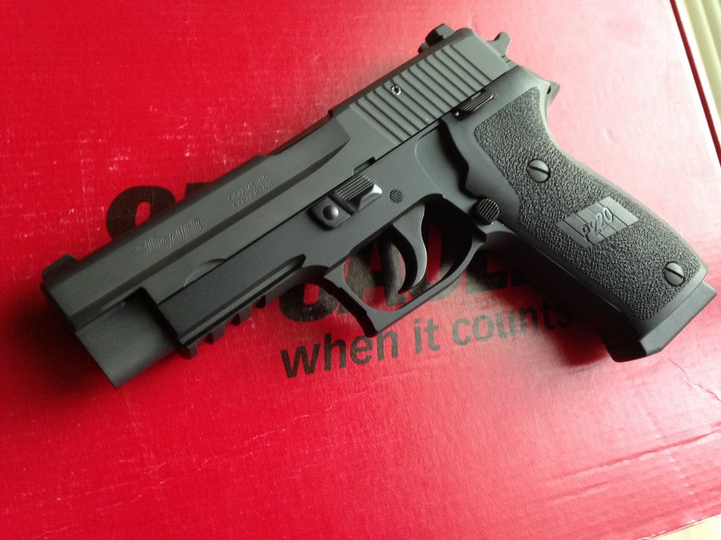

A few years back I bought a CPO 220 DAK pistol from a gun store in PA. At first glance the gun looked fine but when I got it home under further inspection I found a small crack on the frame extending from the magazine release. I gave the magazine release a jiggle and the side wall of the magazine release cut out in the frame crumbled like a dry cracker. I sent the whole gun to Sig and they replaced it. They asked me what kind of 220 CPO I wanted and I requested an SA/DA gun instead of DAK and that’s what they sent me.
Here’s a pic before I noticed an issue. You can kinda if see a little bright metal around the magazine release which I probably thought was a scratch
And here’s the after
Posts: 13190 | Location: Charlotte, NC | Registered: May 07, 2007Reply With QuoteReport This Post
