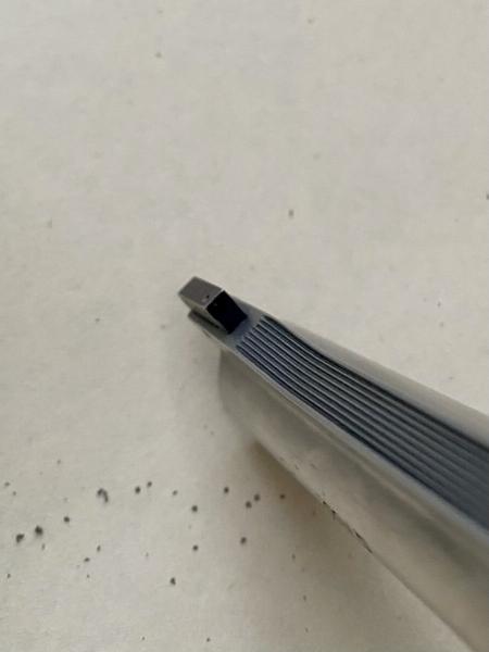

I picked up my 617 mountain gun back in November. Unfortunately I didn’t look over the gun well enough before I bought it and when I got home I noticed that the rear sight was broken. The blade would just slide left to right freely.
I contacted S&W and was told that they would send me a new rear sight. All i received was the forward screw for the rear sight. After another call they told me the rear sight was back ordered and they didn’t know when it would ship. Fast forward to the end of January and the rear sight finally shows up.
I finally made it to the range today to shoot some steel and just get a feeling for the gun. I made it to the 13th round and the brass bead fell out of the front sight. I ended up putting 60 rounds through it and luckily didn’t have any other issues. I didn’t get to put any rounds on paper due to the rain, but I had no issues keeping rounds on the smaller plates at our range.

Go to Lowe’s and get some red loctite or gorilla glue epoxy, mix up a little and slide the brass pin back in. It’ll be right as rain. I had the same happen to a marbles front sight on my little 357 magnum carbine-I used the epoxy. Hasnt come off in over a decade.
The front bead has been donated to the range. I looked for it, but it’s gone for now. The snow/rain on the ground didn’t help.

Maybe get a piece of brass rod from the hardware store and snip off a piece. Polish it up and glue it in . Worth a try .

Or call Smith back and ask them to send you another one. They owe you that much. It's kinda sad when you can't even make guns that will hold up to the mighty recoil of the .22LR.

I’ll be making a call to smith tomorrow and I’ll let them fix it. It’s a shame their QC is the way it is. I really like the look and feel of this gun and I can’t wait until it’s back to 100%.

Contacted S&W and they will be sending out a new front sight. It’s a shame that the front and rear sight had to be replaced, but I really like the way the gun handles and shoots.
