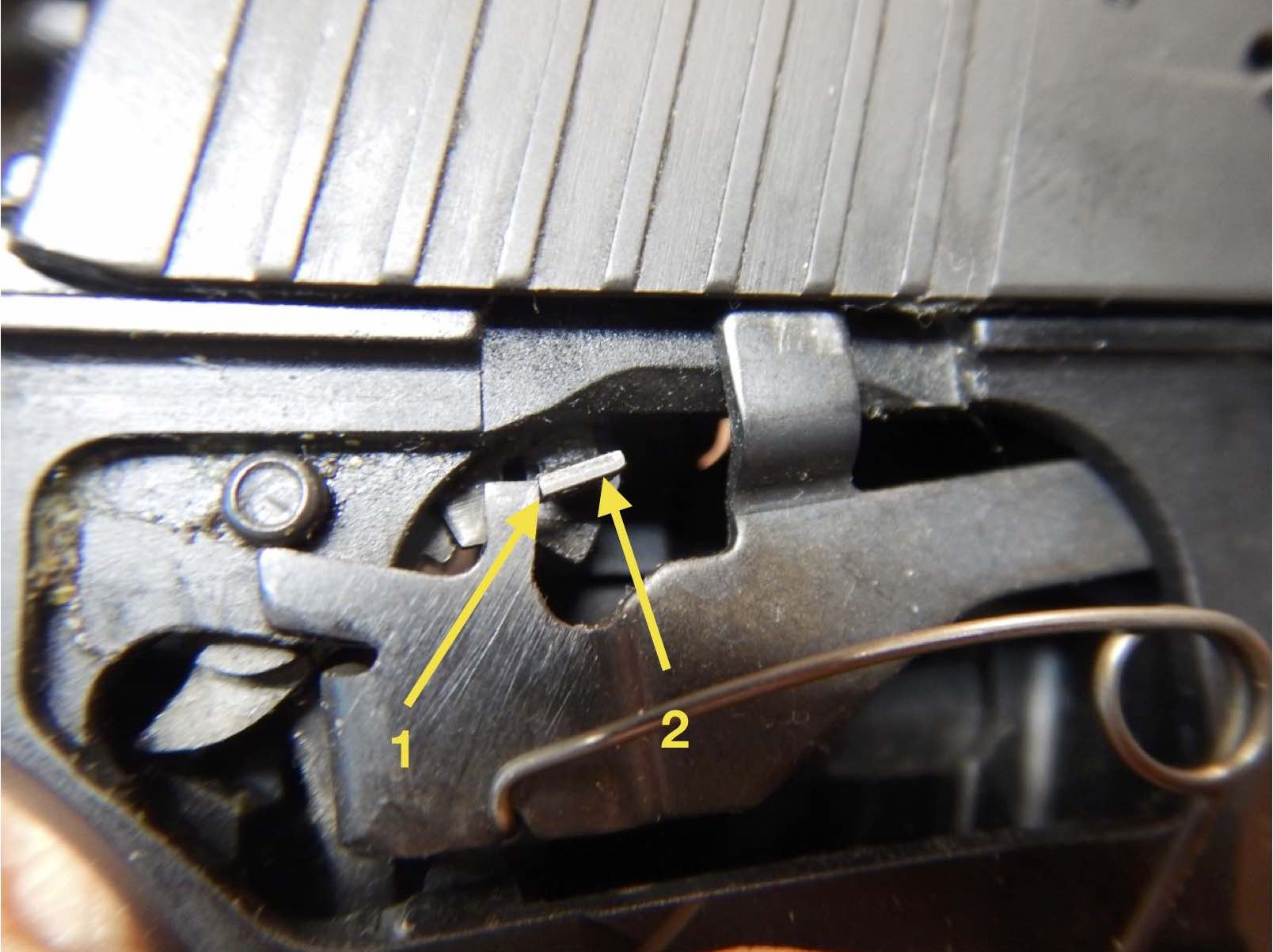

Picture of Blume9mm
I looked at both and it was obvious what is going on.. either the trigger bar is not falling far enough down or the hammer thingy (best I can do) is not going up. and I think it is the trigger bar... Of course right now I'm going to try and clean and lightly lube the bar. Below is a picture of how it looks when the two have not gone into the right position..
Position 1: I is where the tab on the top of the bar is resting on the back of the 'thingy from the hammer"
Position 2: is where the tab should be...
(Sorry for the big picture and yes I see the debris)

Picture of Blume9mm
Well........
Here is what I have figured out the 'problem' was..
It was Me!
When checking the reset I was easing the slide back forward into battery.... If I do it this way about every third time the trigger bar will not 'fall' into the right place...
But when I let the slide slam forward into battery like it would when firing the pistol the trigger bar sets it self right....
(oh, and all that debris you see was actually grease from the slide... someone here keeps telling me you put grease on the slides of these pistols)
Again, thanks for the help.
