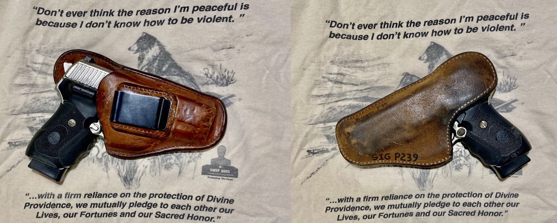

I use an inside the waste band leather holster for my P239 but I more often than not have it outside my waste band but inside the belt... seems the waste bands of my pants have been shrinking as of late.... I need to go check the temperature of the water on my washer as well as the air on my dryer.
But I'm old school and prefer leather. Maybe because it tends to look even better as it ages.
