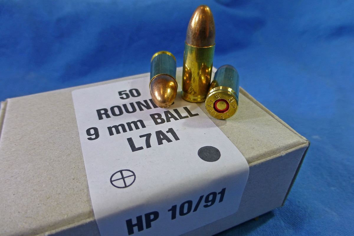

I also wanted a 9mm revolver, so I got a .357 Ruger Vaquero Bisley and found a 9mm cylinder for it. It's a real blast, literally, firing British L7A1 ammo. I need to polish the 9mm cylinder, so it matches the finish of my Vaquero Bisley.
