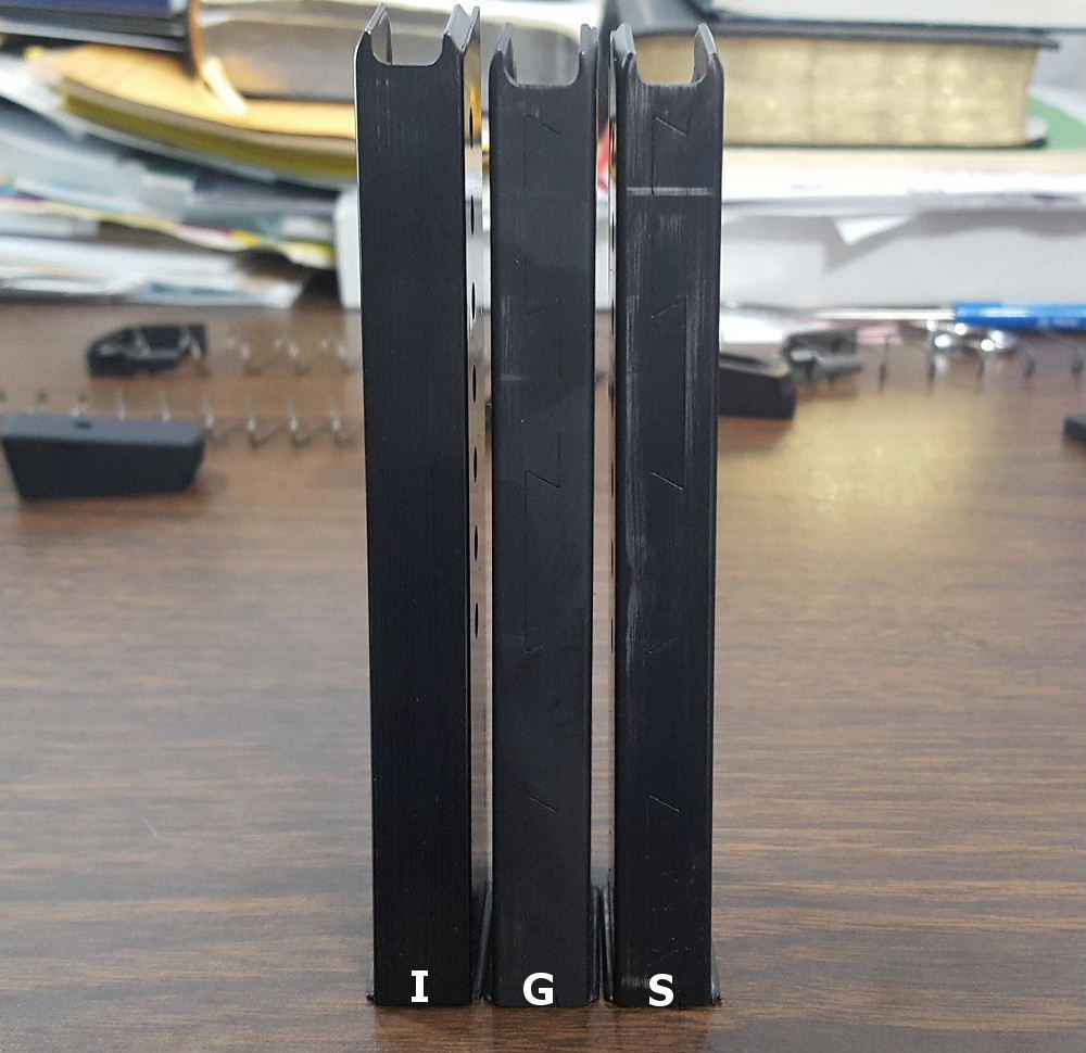

I can confirm that the new magazines do not work with the Swiss heel release P210. I bought two of them to try out and they did not work any of my P210 heal release pistols. The mag body is just slightly too long with an original Swiss baseplate and the heal release will not snap over the end. The Legend magazines will, however, work with the heel release P210 if you switch out the baseplates.

Holy cow! You are right. Curiosity got me. So, I took the bases off all 3 mags (Italian, German, and Swiss) and lined them up. And, lo and behold, the Italian is indeed a little longer. Well, too bad, guys with bottom mag release P210s can't use these cheap Italian mags. But at least, the side mag release P210 is no problems. Photobucket is having PMS again. Can't even get on to get pics. Roll Eyes
Italian mag on left, German in middle, Swiss on right.

It’s possibly to grind about 4/100th off the back 1/3rd of the Legend mag baseplate or replace with a 225 plate and insert with some minimal grinding to make even and they will work in a euro release. Finding the 225 base plates are difficult, inserts are easy
