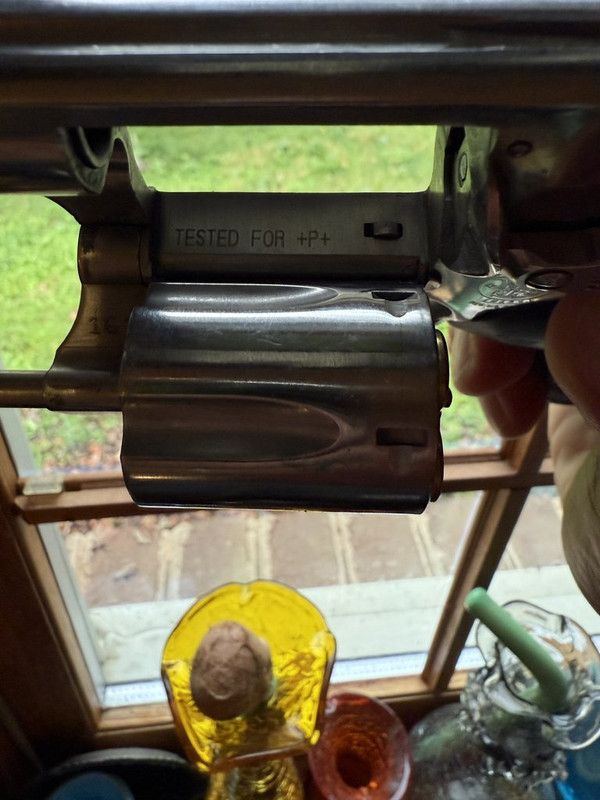

I think there’s enough confusing info to where I’ll stick to standard pressure fodder for this oldster. It’s a nice piece and even breaking a small part might be problematic repairing it. My 640 no dash will fill the role of battering my hand if I get the itch Big Grin

Picture of stiab
Nice, I sold both of my 640s when downsizing, would have kept one if it had the +P+ marking, which means it is an early one.
