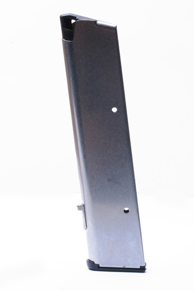

It's primarily an issue with extended magazines, where the baseplate is unable to limit insertion. Such as slamming a traditional Government/Commander magazine into an Officer 1911.
This is why most 1911 extended magazines make use of grip spacers, overinsertion limit tabs, or the like.
