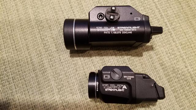

oddball
Received mine last weekend, thanks to DaBigBR!
Compared to my old TLR-1.

Spiff_P239
This picture convinced me to order one from him tonight as well.
