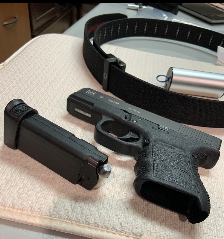

I have a Glock 36 (current production FGR version) that I use as my hiking and "backyard gun". We have quite a few black bears raiding garbage cans and not shy to roam through properties when folks are outside.
It's loaded with the Buffalo Bore 45acp +P hardcast Outdoorsman load. I upgraded it years ago with a Wolff 21# guide rod and spring setup and runs flawlessly.
I took a hog with this combo a year ago and it went completely through, clipping the left front shoulder shattering it and passing at an angle exiting out in front of the right hip.
Obviously this isn't a big brown bear, but the wound track was a straight line after blowing through that shoulder blade, pretty impressive as compared to conventional bullets.

That is a BIG black bear! Nice G36, too. I like the slimmer profile compared to the G30/G29. Does the factory barrel handle the hard cast ok, or did you swap it out?
That is definitely impressive, and thanks for sharing your real-world experience on an actual critter. Hogs are no joke, and I'd imagine that if a round penetrated enough to go clear through a hog's shoulder and out the other side, it's pretty safe to extrapolate that it could reach the vitals on a bear. Your Glock 36 is also a very carry-able gun, which is very much in the spirit of what I'm looking for here...not a heavy, long-barreled hunting handgun, but a small and convenient defensive tool to keep handy for when everything else goes wrong.
Yes, impressive to say the least, out of a compact 45 no less.
