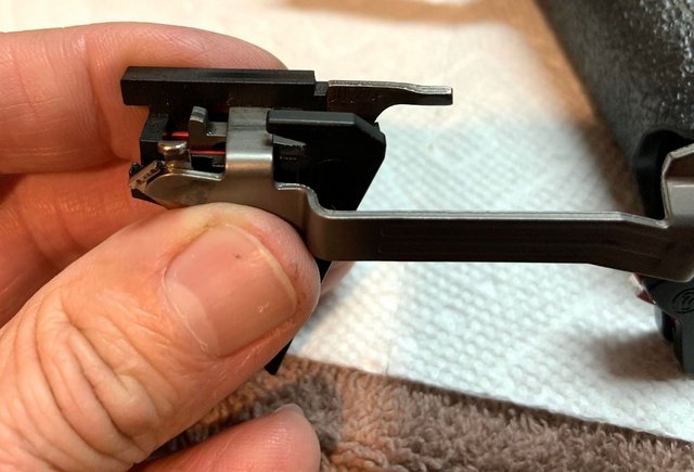

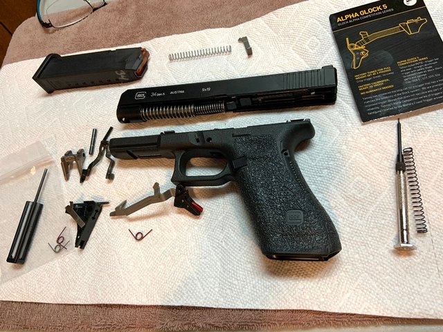

One of my shooting buddies asked me to help him install the new Timney Alpha Glock Trigger kit in his GEN-3 G35. He uses the pistol to shoot USPSA and Steel Matches.

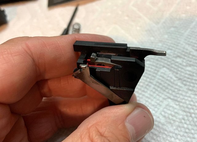

This is really a departure from typical Glock internals. The overall design is extremely innovative and gives the user the ability to simply drop in the parts without any polishing or adjusting and get a perfectly crisp trigger. You also have the ability to mix and match the firing pin spring weights and different connectors to give you different trigger pull weight characteristics.

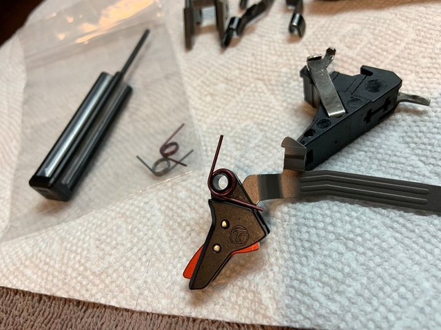

It’s a simple install. Snap the little red trigger module into the factory Glock trigger housing and snug up the set screw on the bottom. Then slip the new trigger bar on top of the sear of the new trigger module and stick that assembly into the handgun frame. There is a small torsion spring that acts as the trigger return spring. That is then placed over a shoulder on the side of the trigger, one leg pushes against the trigger body and the other leg pushes against the underside of the locking block or the locking block pin (depending on what Gen gun you have). The install of this spring is easier on the Gen5 guns, on the Gen3 it took a little fiddling.
At first we tried it with is existing set up, which was a Ghost 3.5 connector and 4# firing pin spring. The trigger was just ridiculously light, and I didn’t test it with the Lyman Digital gauge because it was stupid light.
We took it apart again and installed the factory minus connector from the G35, the factory 5 1/2 pound firing pin spring, and the factory firing pin plunger spring. This put us at 2 lbs. 10 oz., to 2 lbs. 13 oz. on average.
He considered this too light for his shooting style and wanted to get up around the 3 to 3 1/4 pound range. I went into my shop and looked through my parts and I had a Glock Miami connector (+) which is rated at 8 pounds. I matched this with a 6 pound firing pin spring and we tried it again. This gave us 4lbs7oz to 4lbs11oz on average.
We tried again now using the standard Dot connector which is 5.5#, along with a 6# Ghost spring. This gave us 2lbs15oz to 3lbs1oz on average.
Finally we tried the standard Dot 5.5# connector with the standard 5.5# firing pin spring. This gave us 2lbs10oz to 2lbs13oz on average.

We fired it on a falling plate rack at the range and the gun performed very well. The only issue that I personally saw was that the trigger reset seemed to be weak and it was because of that small torsion spring probably being too weak. I looked inside and decided I was going to get the specs on the spring and see if a heavier action spring was available from one of the industrial supply houses. I didn’t have his gun to measure the spring so I decided I would call Timney to see if they had any specs on it.
The gentleman I spoke to was a great guy. We chatted about my experiences with the trigger and spring replacement to give different pull results. He was very interested in customer feedback. We discussed the reset spring and he said that they found that they also considered the spring a little light and they had a new heavier spring made up. He offered to send me some to try in the gun and give feedback.
The new springs have a purple color to differentiate them with the original metal colored weaker springs. I purchased another kit, this time for the Gen-5 Models. I installed the GEN-5 kit in my Glock 34 and installed the original week spring. The gun function fine but after replacing it with the new heavier purple spring it was markedly better.

The module insert appears to have it's own sear, so this turns a Glock into a fully pre-cocked striker instead of a partially cocked striker? If so, then it should feel a more like a PPQ.
Yes, striker is fully cocked. The sear releases it.
