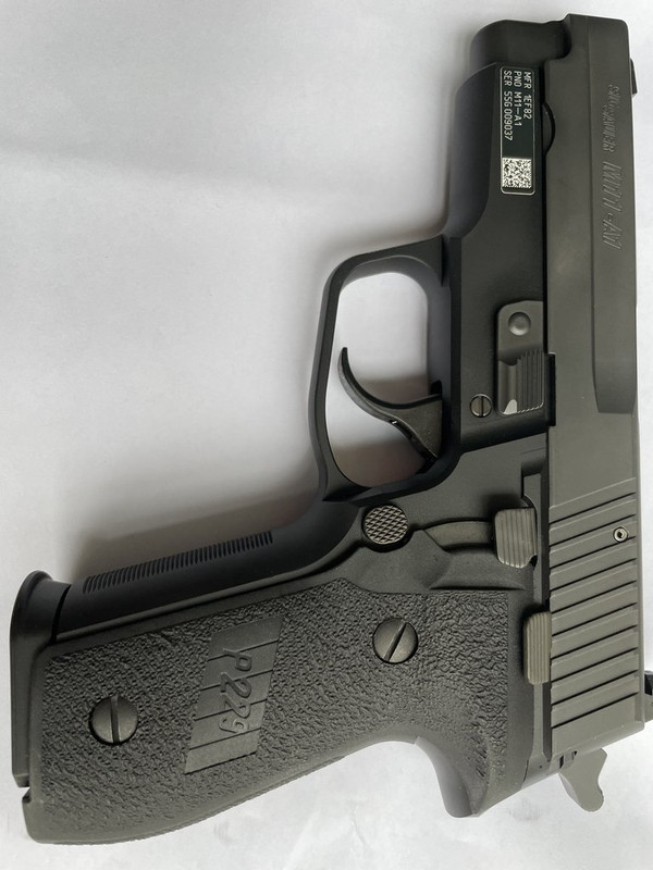

I just replaced the factory installed "short" trigger on my new M11-A1 with SIG's standard affair (TRG-22690-BLK). When firing first shot DA with the "short" trigger installed, I was loosing finger leverage before the hammer released. For me, the standard trigger completely eliminated this problem. I'm a bit surprised SIG elected to supply the "short" trigger with this model given the fact it was previously an optional accessory. I suspect a number of M11-A1 shooters - especially those with larger hands - have replaced their triggers as well. Attached is the obligatory photo of my new M11-A1 with the standard trigger installed.
