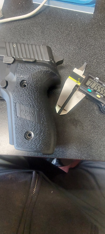

I'll step in here;
Measuring a stock plastic P229 grip thickness is .155 measuring below the P229 pad.
Both G10 and Aluminum call out .175" at the same area on the print. This grip, Chainlink measures .172"

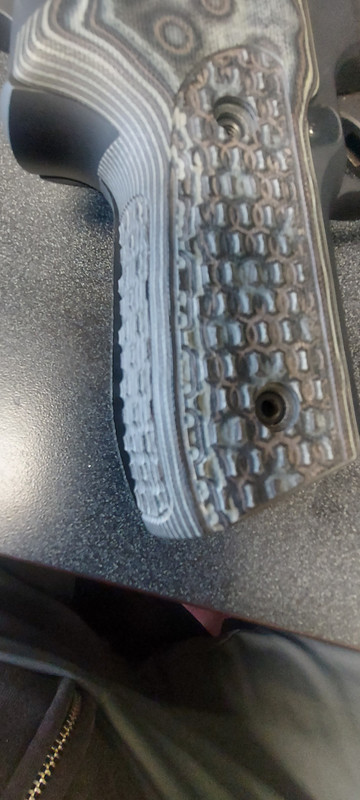

Real Point of interest is the backstrap. Stock plastic P229 grip (on the bottom)verses G10 grip (on the Top)is quite a difference
So, to confirm Hogue G10 and or Aluminum P229 grips are 0.015-.02" thicker than Stock Plastic BUT trigger reach is shorter giving the perceived feel smaller
