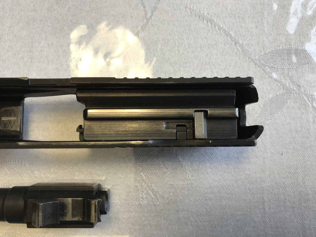

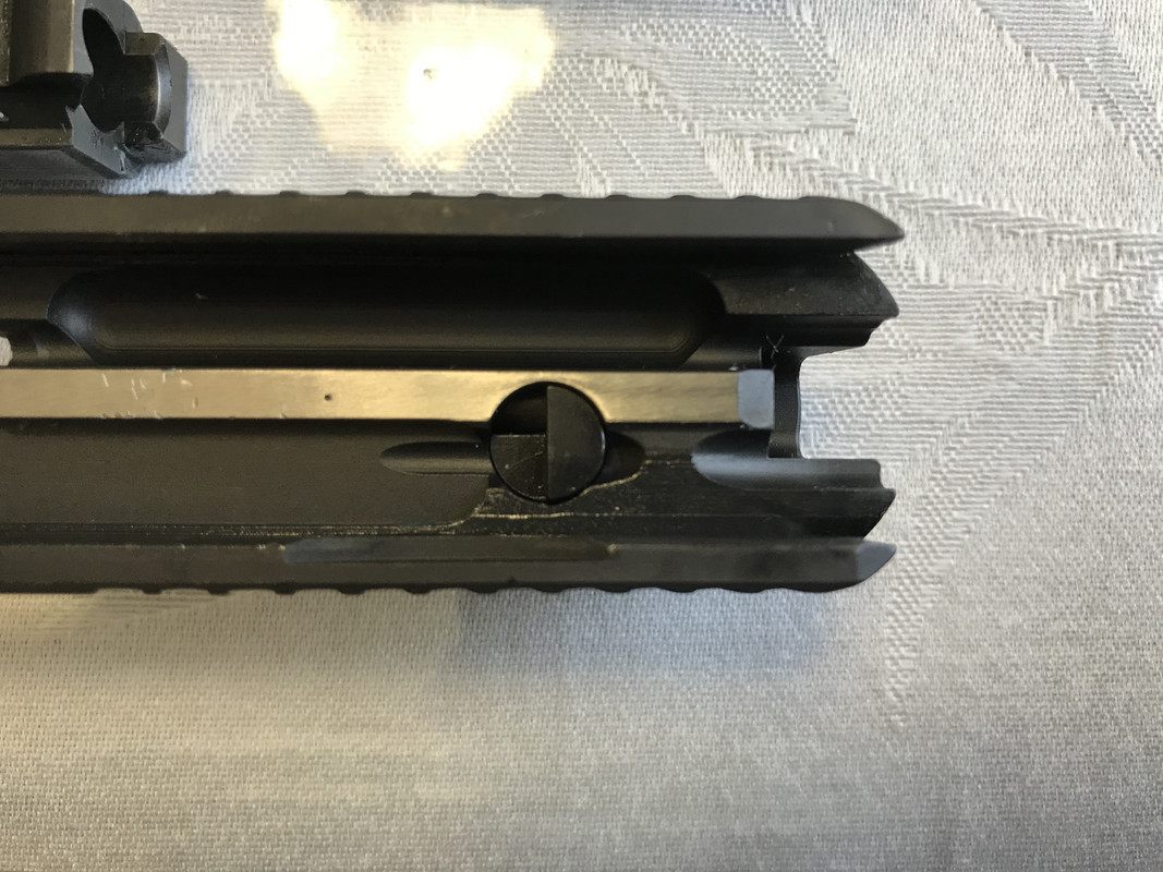

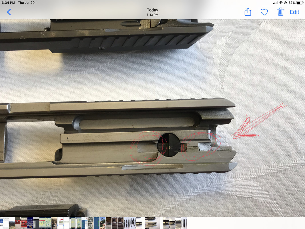

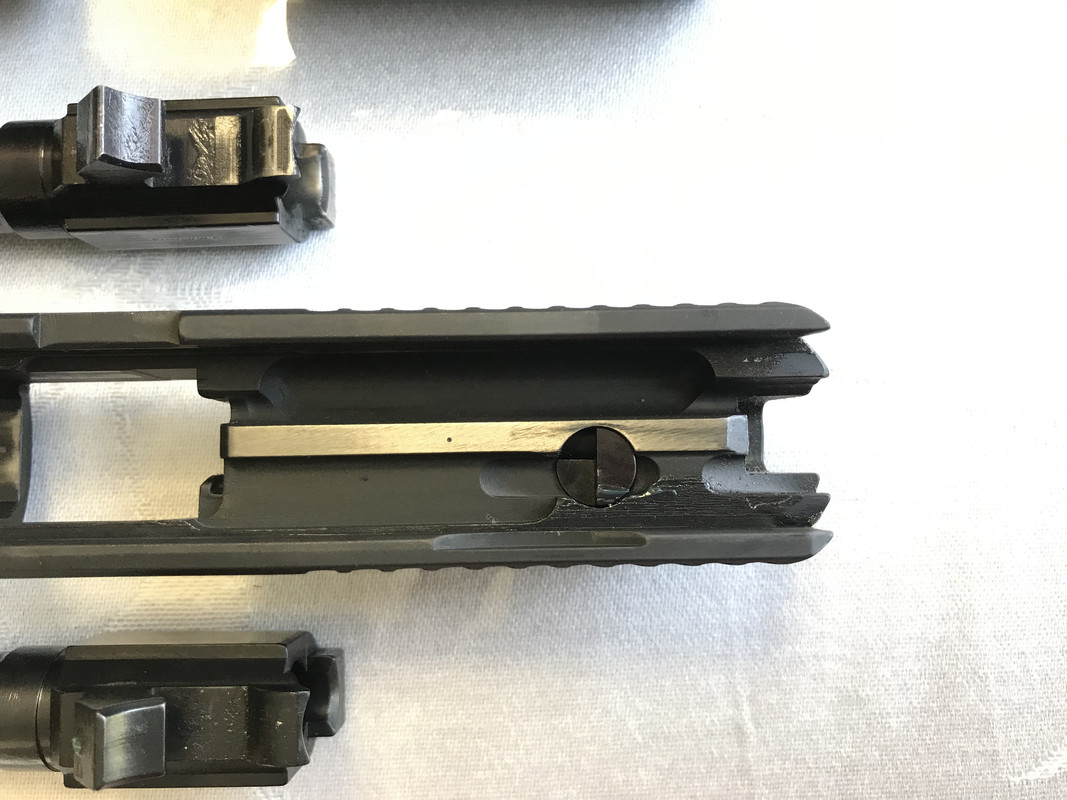

I have some pics of various slides. One is off/for a P228. The rest are P229. I see different style/types or variations in some of the milling. Just a cheaper way? An improvement for functionality?
This is the P228
P229 These are wider
This has squarish cuts P229
These are more rounded P229

Well, the difference between the P228 and P229 is the P228 slide is folded carbon steel, where the P229 is milled stainless. The part of the P228 you’re comparing to the P229 is actually a pinned in breech block. That’s also why the P228 has an internal extractor and the P229 is external.
The minor differences in the milling on the P229 looks to be related more to the bit that they happen to have used rather than any deliberate effort at changing weight. But that’s no expert opinion or anything.
