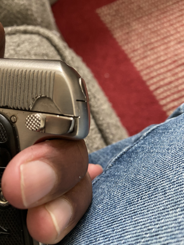

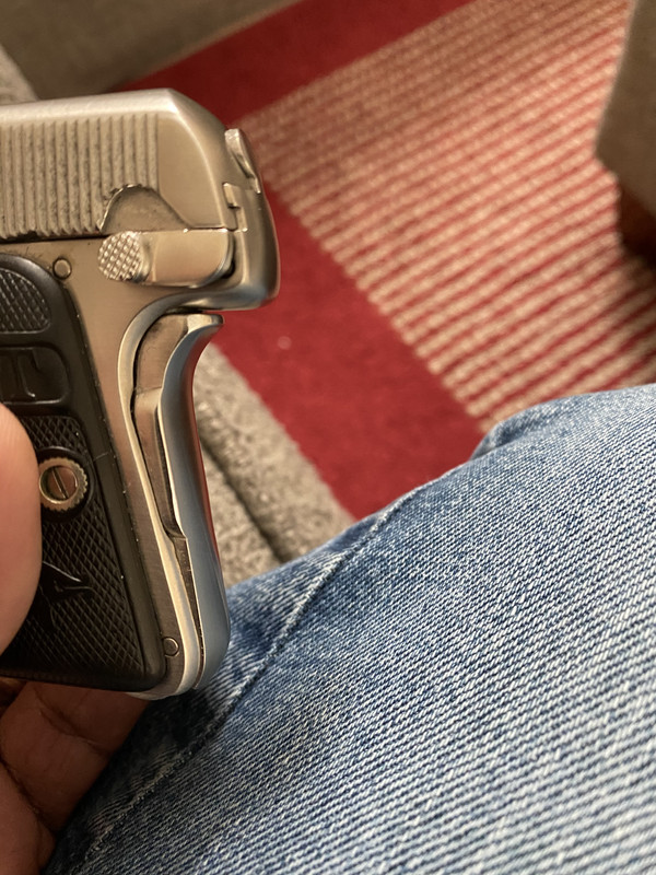

So... I posted a few weeks ago about this little guy and the light primer strikes it was having. After a little digging, I think I have figured out why. The gun was advertised as an original Colt Vest Pocket. Lies. It is a parts gun. The slide is from the first two years of production, the frame is from a gun 24 years later. The first guns did not have the Pony on the rear of the slide. There is also a serial number engraved inside the slide showing the year of production. It is different than the frame.
Long story short, the slide does not fit flush with the rear of the frame. This is causing the striker to barely touch the primer as it has further to travel. I feel it is quite plausible that Colt may have made slight changes over the years in frames and slides leading to my situation. I have been buying, selling, and trading guns for 30 years and this is the first time I have gotten a bad one.
If you know something that I don’t which may fix the issue, I am all ears.
How it should look with me retracting the slide a bit.
How it looks with slide in battery.

So when in battery the slide is too far FORWARD on the frame? I'm not certain how this would result in a light primer strike unless you have a weak striker spring. Any chance the striker has a broken tip?
Also, are you using factory ammo? Any chance of a picture of the gun with a round chambered? Curious if the slide still moves too far forward.
Regardless, you definitely have a parts gun. Hope you did not pay for a collector-grade pistol.

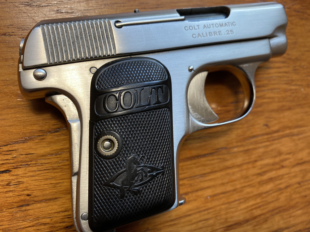

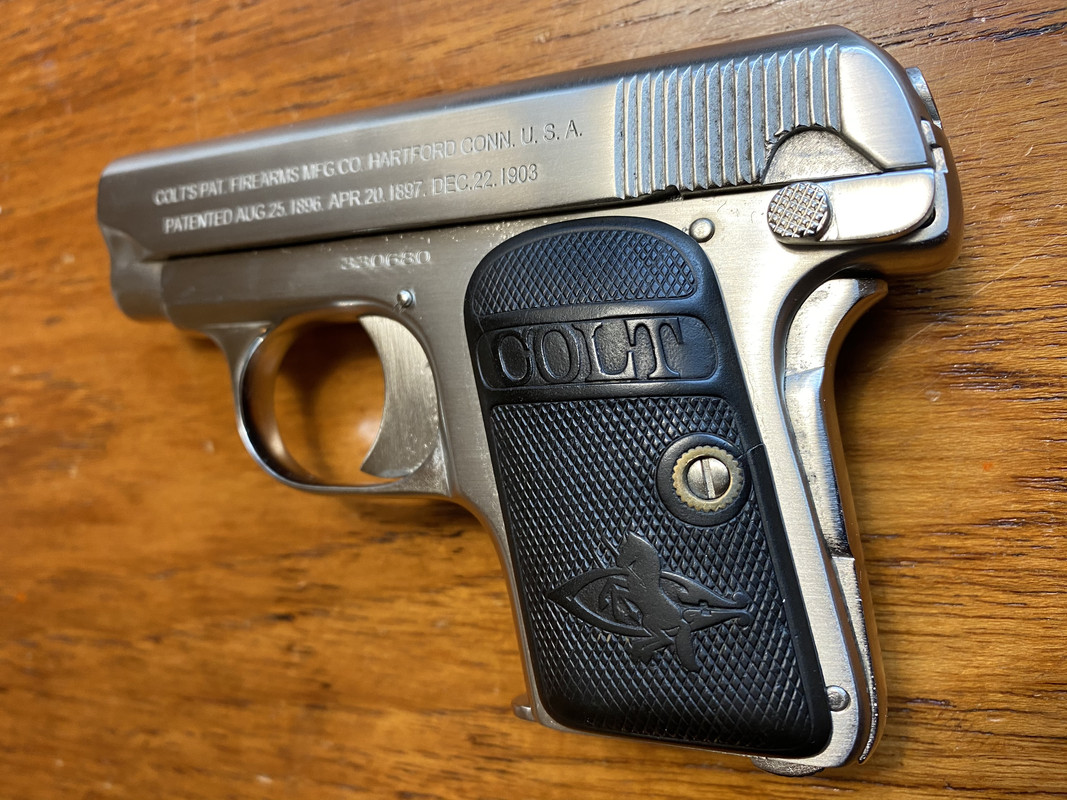

This post got my interest so I pulled out my Colt. The slide frame fit is perfectly smooth like it was polished while fitted. It's difficult to see in your photos, but was both the slide and frame polished and refinished? The barrel is retained with an interrupted thread and limits the forward movement of the slide. If you can, you might try a different barrel to see if that will move the slide to the rear.

Yes, when the gun is in battery, the slide is too far forward. I’m no engineer and may be wrong, but no matter how strong the striker spring is, if the slide is more forward, then that primer is more forward as well. The spring is going to reach the end of its travel resulting in the light primer strike. If the slide was more to the rear, it would strike the primer sooner and before reaching the end of forward travel.
I purchased a new reproduction barrel from In Lead We Trust. I installed it Saturday. It fit well and functioned well, but the light primer strikes are still there, so the new barrel did not close the gap. My new Wolf spring kit should be in tomorrow. If that does not work, I have no other ideas but finding a slide from the same period as the frame and hoping they line up.
Here are a few pics of the gun loaded with a round in the barrel and one without. As you can see, there is no difference.

Intrigued by the way that the slide sits too far forward. I don't think it should stop the gun from firing, but can't figure out why the slide is in this forward position.
My understanding is that the slide stops moving forward when it contacts the back of the chamber on the barrel. The barrel has lugs on the underside that connect to lugs in the frame. So the only way I can see for the slide to be too far forward is if the position of the lugs on the barrel or on the frame are of the wrong dimension.
You've replaced the barrel so by my reasoning the frame is the problem.
Do you know for certain that the frame is from Colt? Could it be manufactured in Belgium by Fabrique Nationale? How closely do the lugs on the bottom of the barrel connect with the lugs in the frame?
At this point I'd try and return it to the seller or part it out.

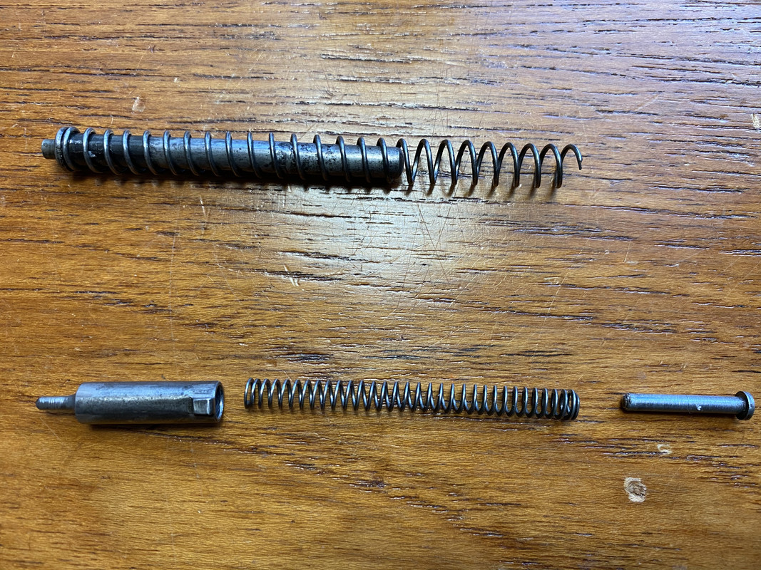

I installed the 1908 Vest Pocket Wolf spring kit. That still did not close the gap. It also made the gun hard as hell to get a round into the chamber. The recoil spring is wayyyyyy to heavy, but.....this morning at the range, the gun only had 3 light primer strikes out of 120 rds. I was getting 5 light primer strikes per mag, so that is a vast improvement and makes me very happy. The only real issue was a few FTF as the little 25 ACP could not overcome the new recoil spring at times. I will be looking for factory springs to fix that issue. All in all, I’m very happy, but still do not know why the slide sits forward as both barrels fit well into the frame.

I wonder if the slide is really too far forward or did they polish the rear of the slide too much during a refinish job? If you can look at another one see how closely the slide serrations match up with the rear rounded pin and the flush pin under the grip (right side of frame). I count six serrations (ridges going right to left) to about the center of that flush pin. If a different gun has a different number I'd say you slide was too far forward; if not I'd say someone polished the hell out of the rear of that slide.
Only thing I can think of. But man that is a pretty gun!

This photo came from Turnbull Restorations of the same pistol. Just for comparison about the extreme polishing theory.
My opinion is, there is a replacement barrel in your pistol, maybe from a different date or run, causing the slide mismatch and firing problem.
