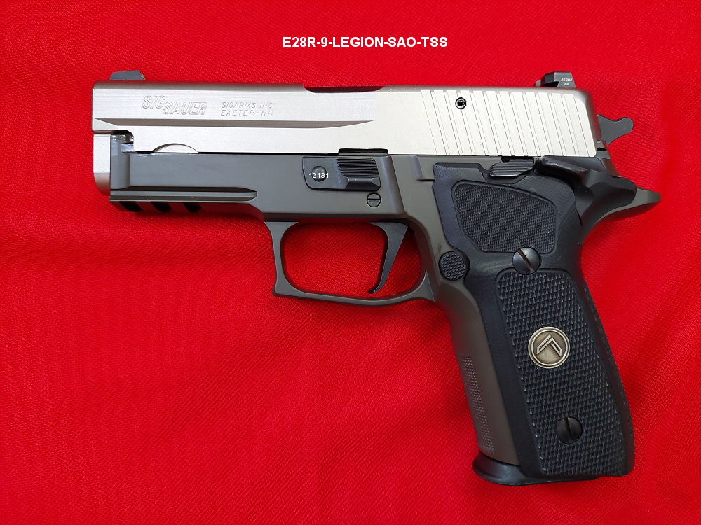

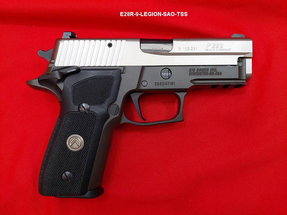

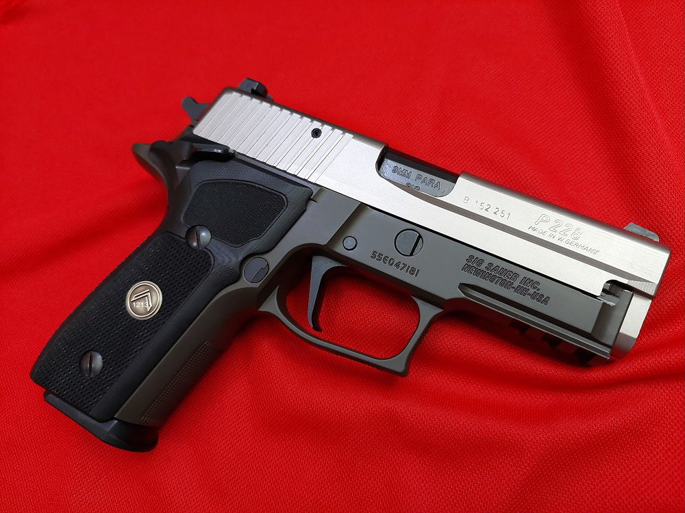

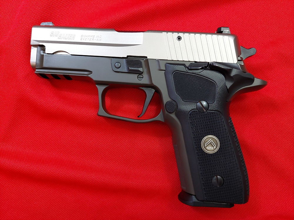

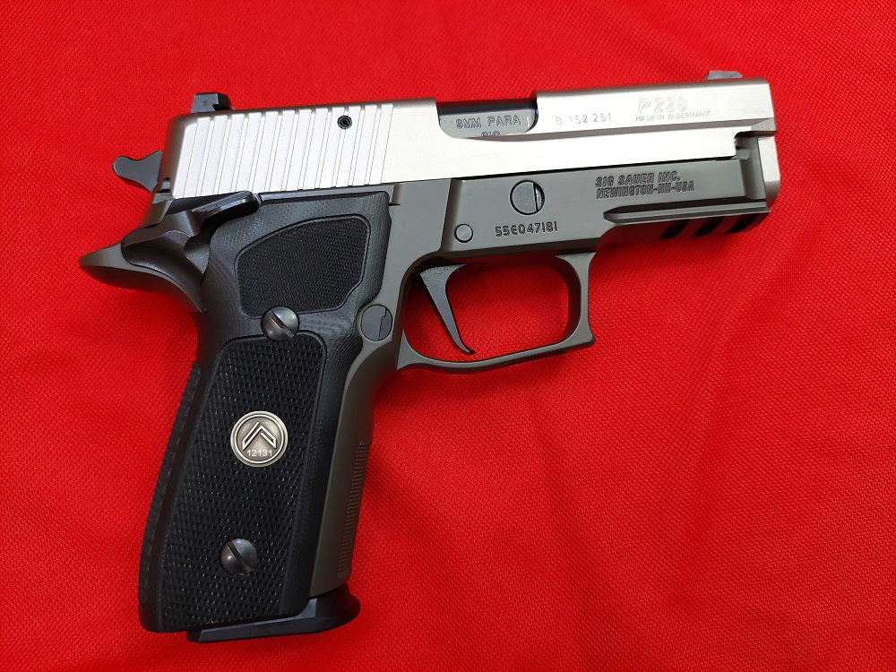

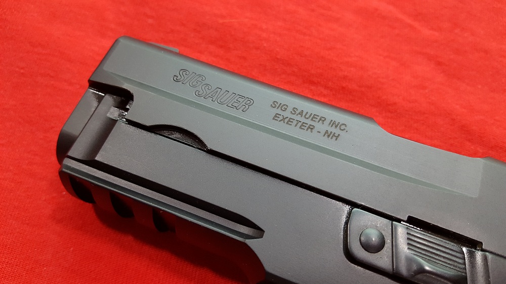

SIG doesn’t make them. Their concierge service is all about the P320. The old P-series guns are now their stepchildren. So why not DIY?

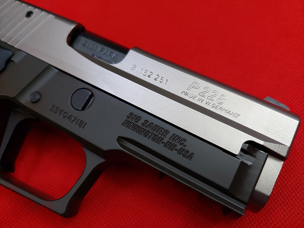

Upper assembly: from the KB factory Nickel gun that I abused and managed to crack the frame at 25k three years ago. It's still in outstanding condition, sitting around doing nothing, begging to function again.
Lower assembly: I was able to secure a nearly new complete P229 Legion SAO frame elsewhere. And the rest is history.
12131’s own Part Number for this SIG: E28R-9-LEGION-SAO-TSS Big Grin

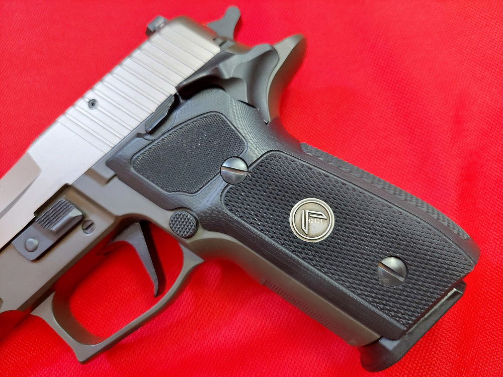

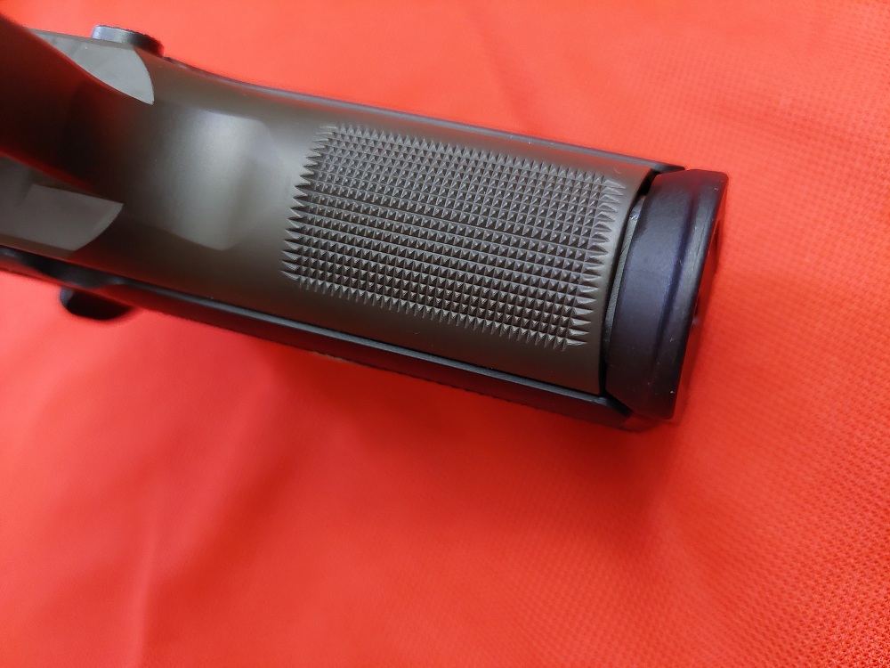

Interesting frame color finish, like a darkened ODG, which matches quite well with the Nickel slide to my eyes. Typical P228 with the Hogue G10 Checkered grips, it feels great in hands, made even better with the front strap checkering. The safety lever is just perfectly located for thumb riding without worrying about inadvertently hitting the slide catch. I have P226 SAO Xguns, but the compactness of the P228/229 SAO feels just about perfect. The straight trigger with the smooth face is ok. I’d rather have one with the grooved surface for better purchase. For a production gun, the actual trigger pull is very good/excellent (at 3 lbs 6 oz average of 10 pulls). I know it’s all subjective, but the only reason for me to not rate it outstanding is that it is just a bit mushy right before the sear “breaks”.

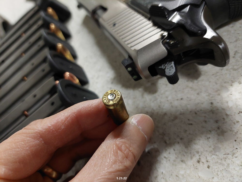

Took it to the range a couple of days ago to verify actual function. Shot 200 rounds of Blazer Brass 115 Gr FMJ. There was a single hiccup that was not weapon related, due to a dud primer.
After this, I decided to retire the barrel and replaced it with a brand new one that SIG recrowned and finished in DLC for me 3 years ago. Overall. I am extremely pleased with my FrankenP228LegionSAO. Cool

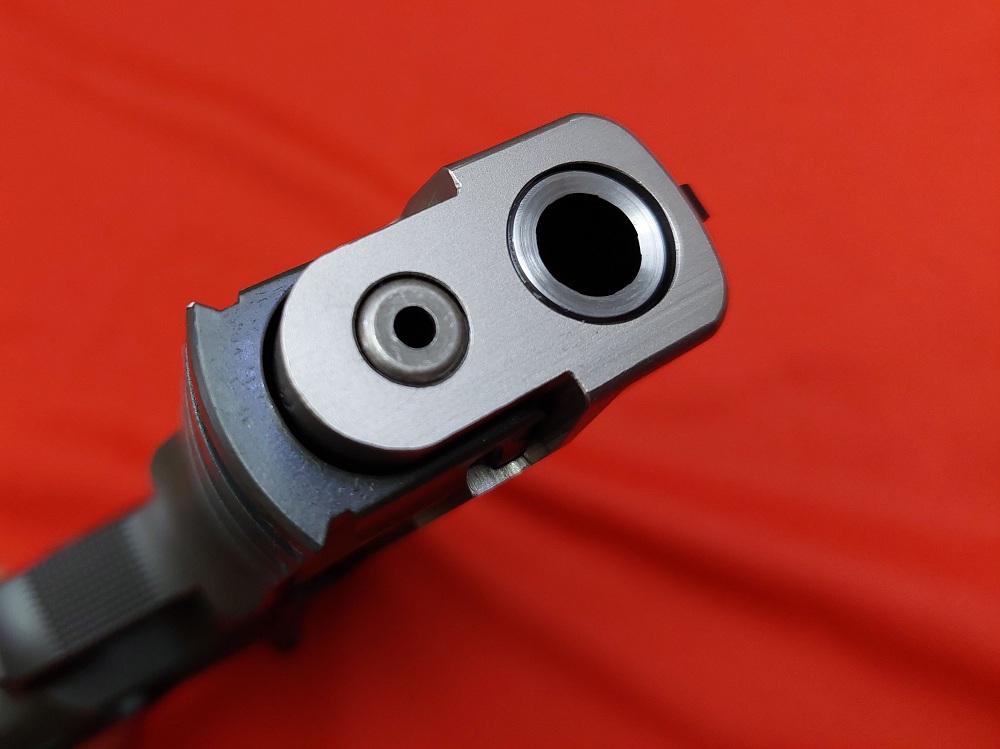

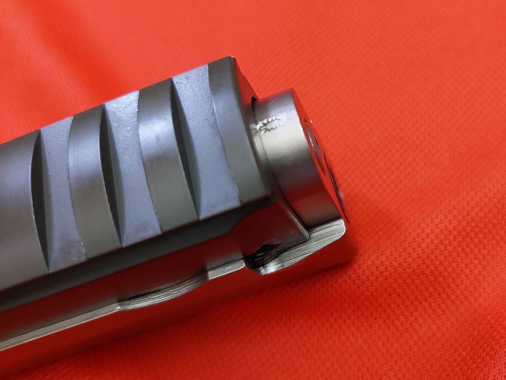

Do all P228/229 slide rails protrude at the muzzle end, or is that to do with the hybrid config?
Posts: 19051 | Location: Spring, TX | Registered: July 11, 2011Reply With QuoteReport This Post
Originally posted by lot_45:
Did the frame need anything other than the matching locking block for that old school stamped slide?
Great that you asked, and because I discovered some new thing, the topic deserves a thread of its own, so the answer is here, https://sigforum.com/eve/forum...0601935/m/9670038884
But, the short answer is no, it needed nothing.
Originally posted by P250UA5:
Looks nice.
They are all like that. Here is pic of a P228R German.
