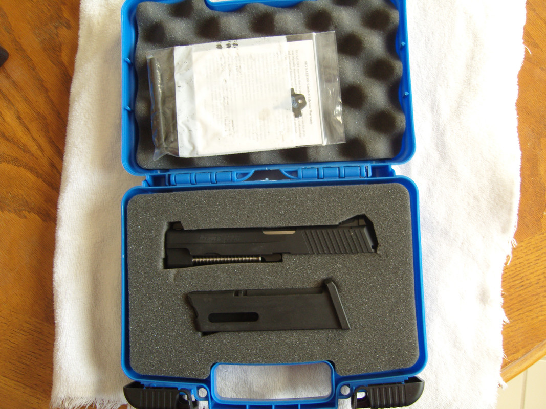

If your Browning BDA has a push button magazine release, the US type P220 .22lr conversion kit is a drop-in-and-go. If your BDA has a bottom magazine release, you will need to use a European type bottom release P220 .22lr conversion kit.
US Type P220 .22lr Conversion Kit
European Type P220 .22lr Conversion Kit

The conversion types have more differences than just the magazines and magazine releases.

Thanks for everyone's input. Appreciate the photos of the Euro P220 kit in particular from MG34_Dan. At least now I know what to look for...
