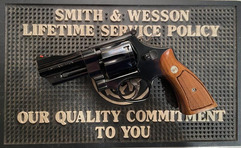

I sent my Model 27 in to Smith & Wesson two years ago along with some other work and the red ramp insert works fine. I don’t think they have the setup to do it regularly anymore, however they took care of me. Might be worth a call.

That is sharp
________________
Posts: 38780 | Location: Logical | Registered: September 12, 2004Reply With QuoteReport This Post
Picture of GOTSIG
Thank you jljones. Been so long since I posted a pic I had to relearn how! Roll Eyes
