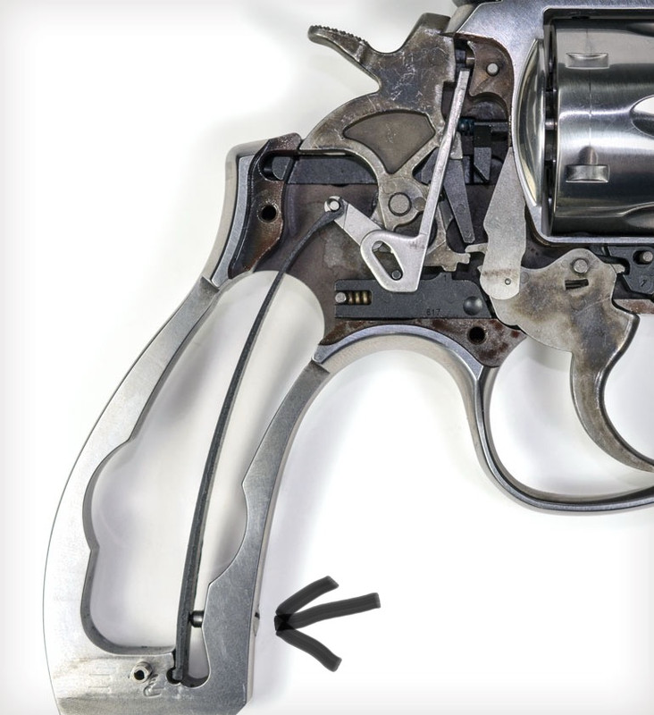

About 6 weeks ago tried out a new bear load, 49th State Cartridge Company 250gr XTreme Penetrators in .44 Magnum. They were 100% reliable in my Smith 329, but only 50% reliable in my 629 Mountain Gun. Even with a second strike the primers failed to ignite, but they would ignite on a 3rd strike from my 329. Frustrating in that my Mountain Gun was my woods carry revolver for years before getting my 329 and I never had an issue with it. Does not inspire confidence when your bear gun goes click instead of BOOM!
Friend of mine suggested checking the strain screw. So I pulled the grips and put 2 full turns on it. Out at the range today with a second batch of the same ammo and the gun was 100%. Wish I could say the same for my hand…

OK, let's see the strain screw.
It is the screw on the lower front of the grip frame ( typically. Concealed under the grip) that tensions the mainspring- present on K L N frames
It should be fully tightened down. People erroneously think it is an adjustment ( looser screw lightens trigger ) but that is not the case.

It's the screw at the bottom of the grip frame to keep tension on the leaf main spring. This is on my 610 Mountain Gun that I had issues with at the range today.
