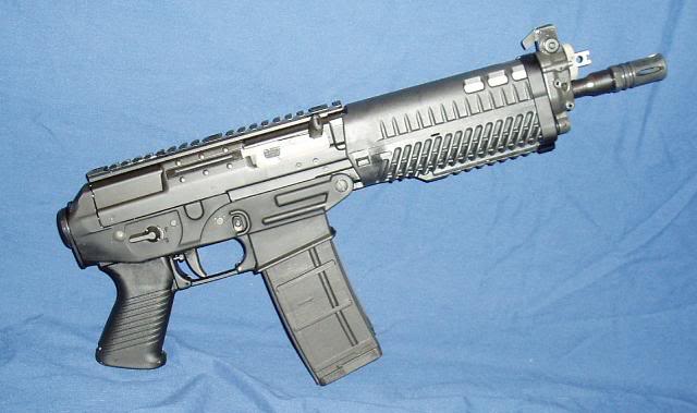

Okay, here's a few pictures of my P556 . . . . . . .
I believe mine is one of the older models as I waited quite awhile before eventually purchasing it.

Pretty sure you just unscrew that cap there on the end and you can thread on a buffer tube.
No adapter needed for your model.

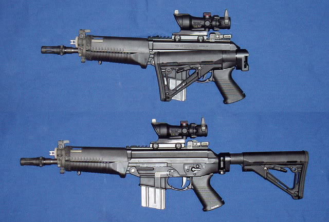

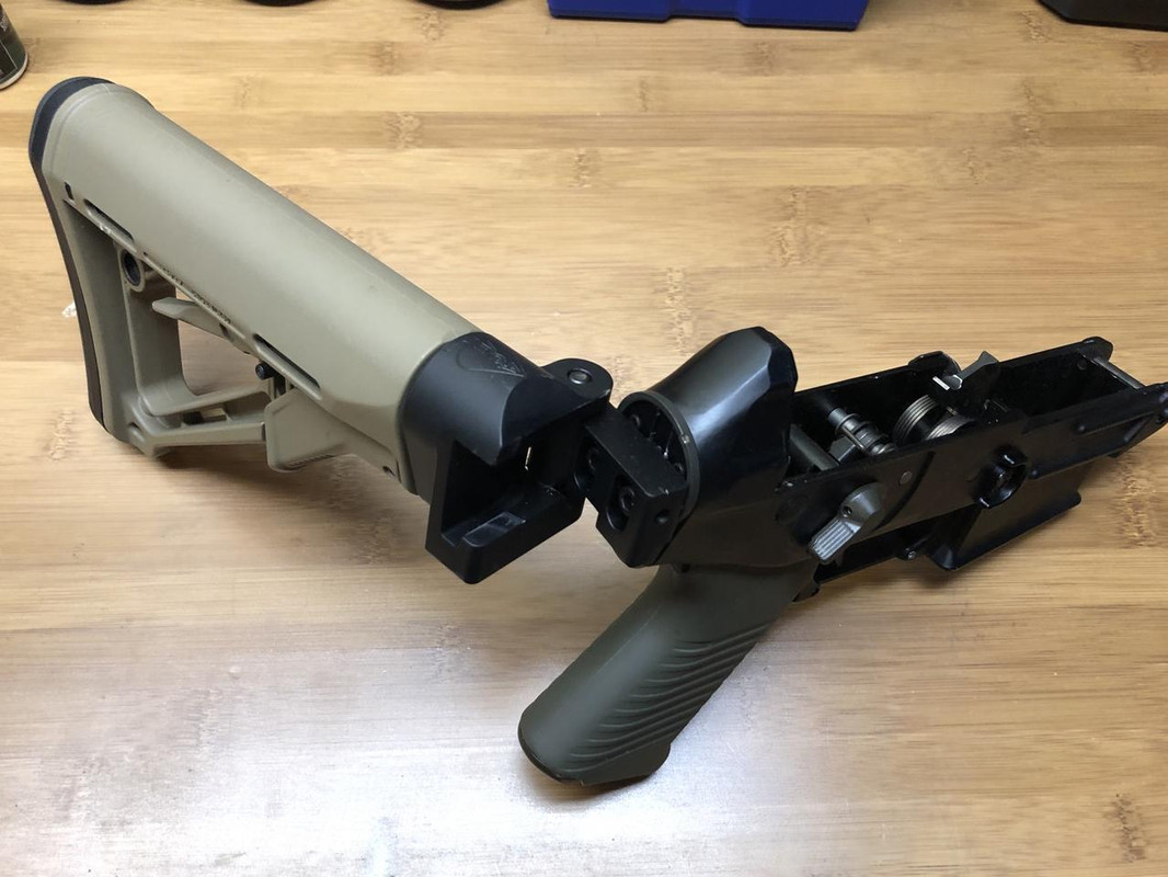

Oh it works ... beautifully.
Mine has gone through evolution many many times ... It was an early one, I brought it home looking like this
at one point it used the ACE hinge
Then I bought a "Classic" lower for it, at first with an M4 stock adapter from DDLES. At some point it got a SiCo mount to replace the SWAT muzzle break and later the Xi lower and the last noticeable modification was the MCX adapter and stock and a SWAT hand-guard. Lastly and finally I came across a gas valve with a suppressor and not drilled at all for a single shot setting and I think I'm finally done.
I think if I were to ever get another I'd use the Ace hinge with a tail hook brace.
