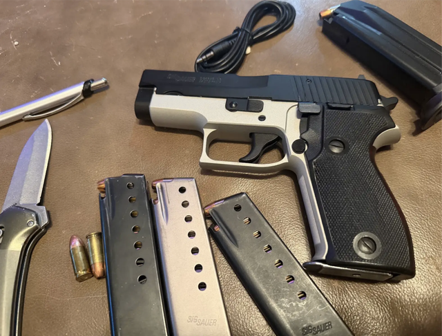

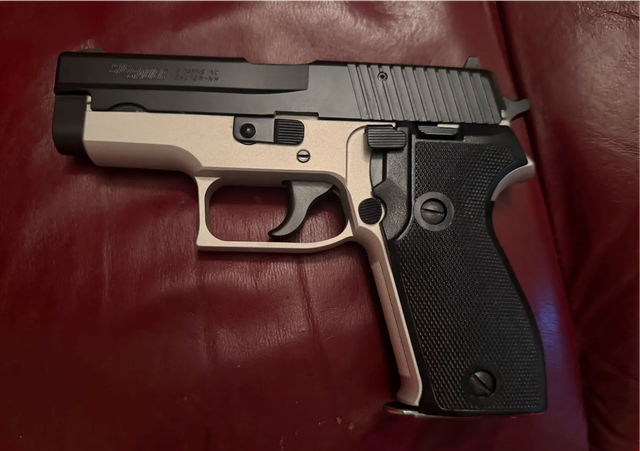

Olwell Pratten
Got the P225 back from getting cerakoted. Cannot wait to fire it.
Working on the embedded pics. Thanks again to maxwayne for the magazines.

Picture of 1KPerDay
Nice!
