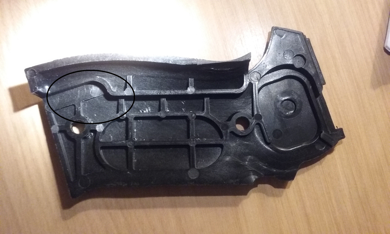

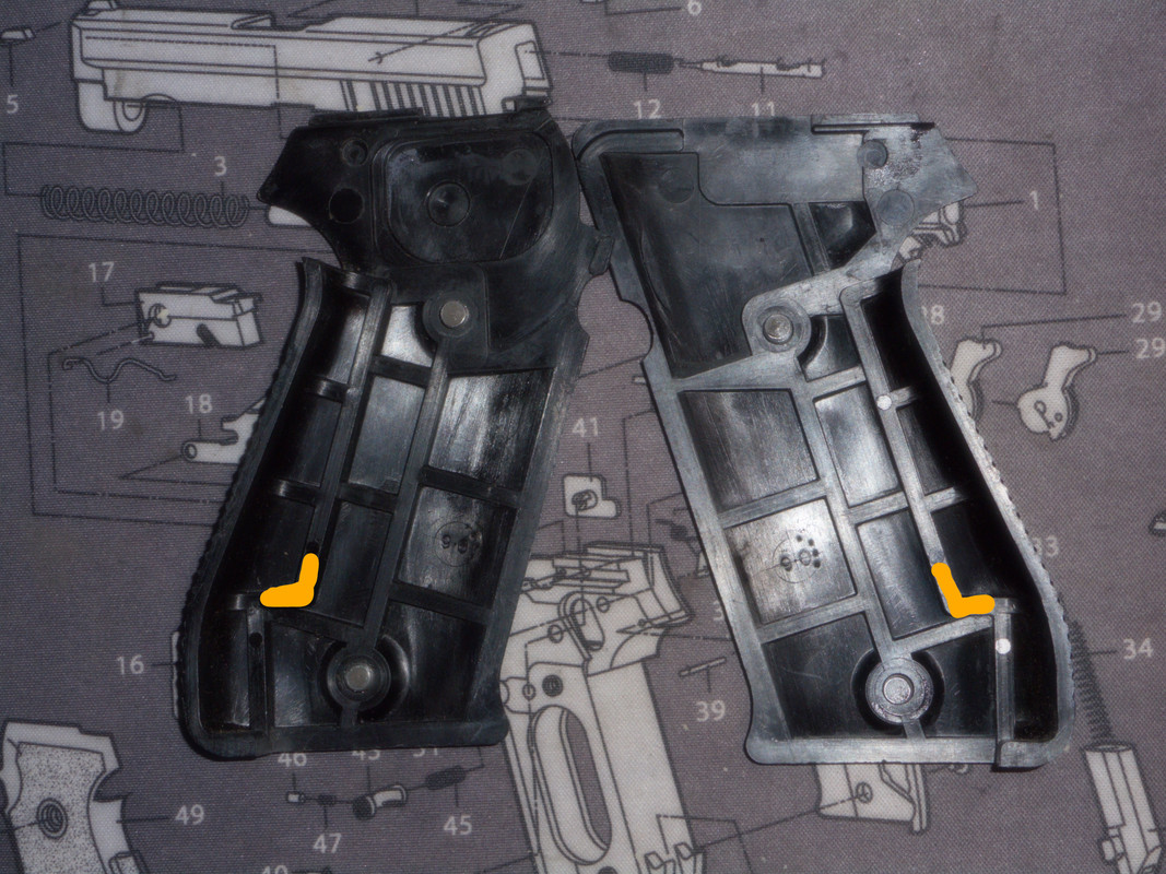

Picture of Sig210-6
Thanks, found out this area needs to be trimmed from the early grip.
Early plastic
Later Poly

the hammer strut design change so yes, it can be done if you want to modify the grips or swap strut assemblies but not a direct fit as has been previously mentioned.

Yes, thanks. I will just trim some early grips to fit. Have never figured out why Sig ever changed them. LOL LOL Kidding, they have just been my favorites since the day I bought my 1st 226 in 1994. Probably just me,
