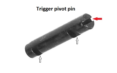

I used a dental pick, worked like a charm. A wooden toothpick (the round kind, not the flimsy squared-off type) makes a great non-marring tool and rudimentary slave pin for installing the sear, too. Those, a good set of punches, a screwdriver set with a wide variety of flat-ground bits, and you should be good to go.
Also, the trigger pivot pin goes in with the slots facing DOWN, and lower the hammer before trying to install the locking insert.
I know you know what you're talking about, but for those who are new to this, the "slots" (the vertical arrows) are really supposed to be facing forward/slanted down, but not completely down. When they are in their correct position mentioned, the external slot facing the left side of the frame (red arrow) will be in the horizontal position. If it's not horizontal, the locking insert won't go back in.
Also, the slide catch lever must be in contact with the frame, when sliding the locking insert into the frame. Otherwise, no go.
