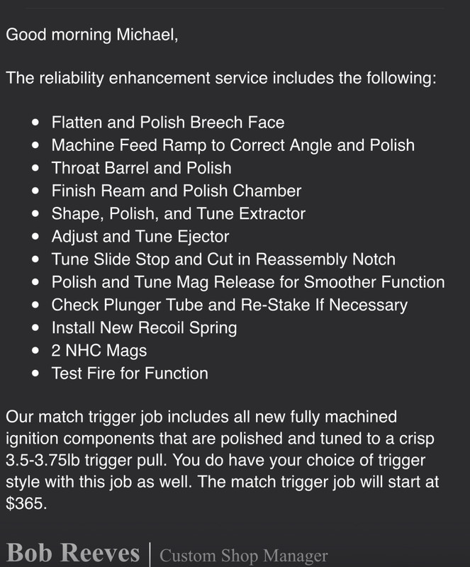

I have a full rail, Springfield 1911, TRP in .45 that I love and seriously doubt I’ll ever part with. I admittedly don’t shoot it a ton, but it’s not a safe queen either. I contacted Nighthawk to ask about their “reliability package” and was quoted the below for $383. I know good work costs money, I don’t really have an issue with paying.. I guess I’m debating on the perceived difference I’m going to notice. What I’m after is just smoothing things out some..An actual “trigger job” is another $365 if I remember correctly. I’m interested in y’all’s opinions.

Seems like a reasonable price, but if the gun runs as-is, I'm not sure that you're going to notice much of a difference.
If you want the trigger improved, you might consider doing the trigger job instead of the reliability package (if that is an option) and maybe replacing the recoil spring and firing pin spring if they haven't been done in a while.

Unless you are having reliability issues, then getting the Reliability Package is a waste of time and money. However, that trigger job will also replace you MIM trigger internals with billet components that can be tuned to a much finer degree and get fitted to your gun by some of the best 1911 smiths out there.
The biggest thing you didn't mention is the timetable. Nighthawk was about 12 months out on Custom Gun orders a couple of years ago when I checked. Odds are good you aren't going to see this gun for a while.
Another idea is check with Skips Gunz.
https://www.skipsguns.com/coll...11-2011-gun-services
A trigger job using your existing parts is around $100 while for $300 he'll replace your trigger guts with an EGW Ignition Kit that a lot of custom houses use. As long as you're only doing gunsmithing work, he can do it within a week, but you'll have to check what his lead time is.

Thank you, y’all have pretty much steered me from the idea of needing the reliability package. My goal was just to “tune” the gun some.. I have an account with EGW, I bought a bunch of their parts for a previous 1911 I owned. The 1911 is not a gun I have a lot of experience with. Thanks for the recommendation on Skips, that’s a good idea.
