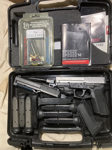

the difference in the extractor width is the concern... and with 9mm you might not always get full ejections.... Just a barrel and spring swap works on some pistols... but I would not trust my life to it... as for less costly practice using 9mm, go for it.
Oddly, I have a SP2022 I did the opposite to but I changed out the entire slide to go to 357sig. Guess if I ever get back to my gun club I could try it with just the 9mm barrel and spring. All purchased from good members here:
