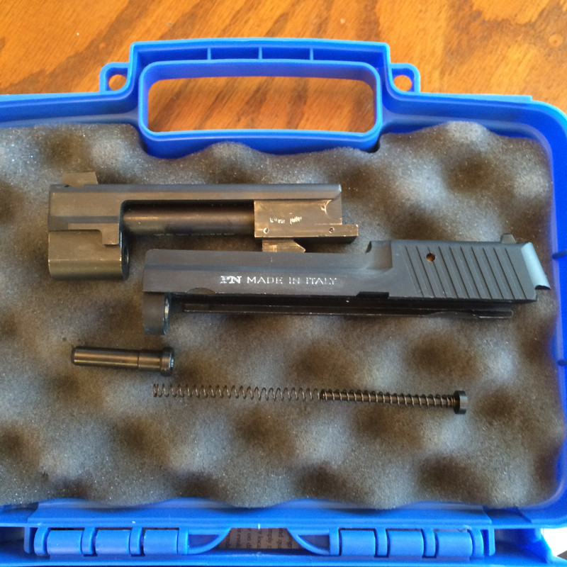

Picture of MG34_Dan
Originally posted by hrcjon:
AFAIK Sig makes the only conversion units.
Hmm. Well, maybe not.
This appears to be a prototype P226 .22lr conversion made by the Italian firm of Pietta. I have never seen another like it.

Picture of MG34_Dan
Yea I know this is an ancient thread. But I thought everyone should know that I'm going to revive this Italian conversion and place it onto it's own lower receiver. It may take some time, but I'll get 'er done. This project will clean my mind of the search for a Hensoldt BLITS manual.
