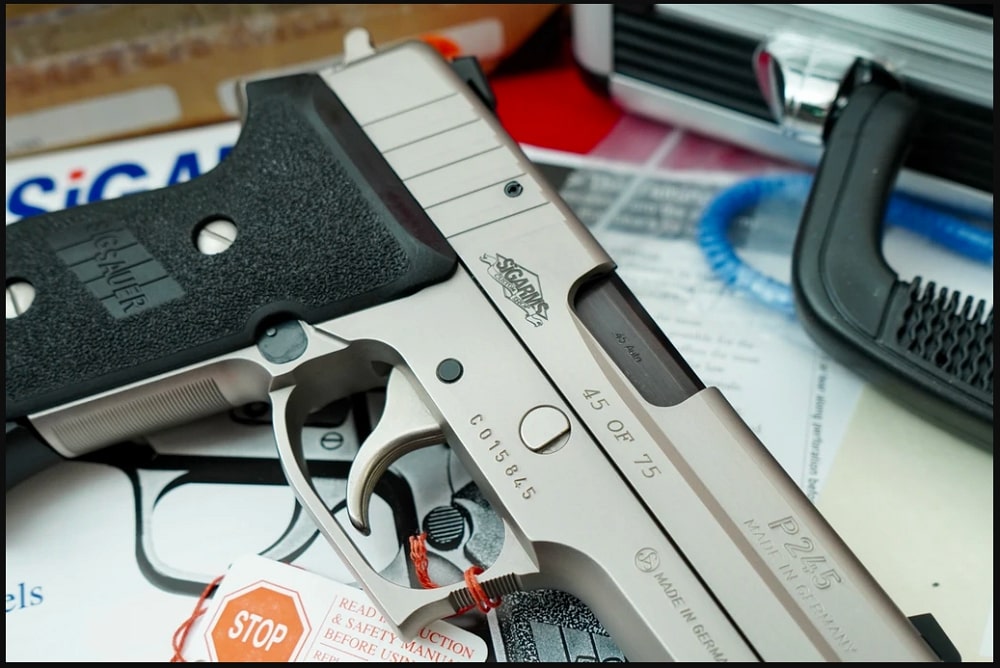

Frank, I don't own a Ni P245. In fact, I've never owned any P245. But, the following are what my internet research tells me.
1- The factory Ni P245 appears to have been offered at two separate times, one in 1999 and the other in 2004. There might be others, but I only am aware of these.
Yours falls in 1999. Production number is unknown. Unfortunately, there is no way to tell with certainty if yours is factory finish, since the original case is gone. And calling SIG will be like chasing rainbow, because they will tell you their records don't go back earlier than 2005 Roll Eyes . But it falls in with the other 1999 Ni P245s I've seen. There are two in > THIS < thread, one owned by Blue Dog and the other by sigmonkey. The only difference I see between yours and theirs are the sights. Yours look like night sights, and their are contrast. Previous owner might have swapped sights on yours? Factory Ni SIGs at this time were still being plated by Klein. They stopped doing firearms at the end of the decade.
2- The 2004 guns are NH Custom Shop offering and limited to 75 total. These guns has the Custom Shop logo on it, plus their assigned numbers out of the 75 made laser engraved on the slide. You see that, in the linked thread above, sigmonkey has two, and pulicords has one. I also saved the info on this one below that was sold on GB in early 2022. It is #45 of 75. The gun is NOS, complete with everything, COA, big metal case, outer cardboard box with all factory labels.
Part Number: 245-45-CS-1
Serial #: C 015845
The auction description is what I found interesting. It says, "Introduced in 2004. This .45 ACP pistol limited to 75 guns. Features Teflon-impregnated nickel slide, frame, trigger, hammer, etc. Hand-tuned action. Target crowned barrel. Novak low-carry sights, limited edition markings. Weight about 27 oz.". We know that Klein was no longer doing firearms by this time. So, who did the plating on these P245s? My guess is ROBAR. Teflon-impregnated nickel would be NP3. ROBAR invented NP3, and his firearm division was in full swing at the time.
Another peculiar detail I noted is that the GB gun has "MADE IN GERMANY" marking on he slide, but the other guns from the same batch of 75 do not. Very odd.
Posts: 31629 | Location: TEXAS | Registered: September 04, 2008Reply With QuoteReport This Post
Serial #: C 015845
Another peculiar detail I noted is that the GB gun has "MADE IN GERMANY" marking on he slide, but the other guns from the same batch of 75 do not. Very odd. …
Serial #: C 015845
