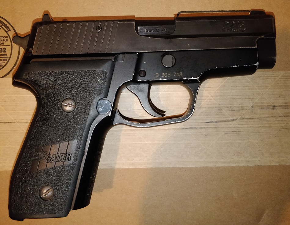

CCR magic on my beater P228.
I will see if I can find a before picture.
Found one. Before pic

Chowser, what finishes were applied to the frame, slide, and controls on the 228?

CPII/Nikote
The Glock has a CPII slide.
