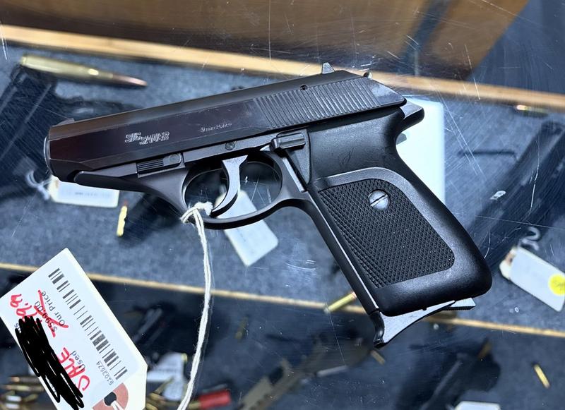

So I came across this 230 and it peaked my curiosity. It’s got no import marks that I can see, no proof marks, and no date code. The front of the slide seems to have some extra heat treatment. The sights are black, no white dot or line and seem to be taller then a standard 230. The caliber is an odd duck and looks like they were made for the Zurich police but this one didn’t have the police shield/stamp on it. Anyone else come across one of these?
Some gun importers took the extra time and effort to hide their import marks under the grips/stock. This is more common on earlier imports, before they began cracking down on the import marks having to be "conspicuous" and able to be seen during casual handling without requiring any disassembly.
Fiocchi still makes small runs of 9x18 Ultra ammo if you want to shoot one of these. But it's not cheap, at 60+ cents per round for basic FMJ.
Or Graf & Sons sells just brass if you're set up to reload. It uses standard 100ish grain .355 9mm bullets like .380.

You might want to consider buying that. They're quite uncommon in the states.
My commercial version in the correct piano-hinge red cardboard box numbered to the pistol, and commercial Walther PP Super in the same caliber.
Remove the slide and there is probably a two letter date code along with proof marks (on left side of barrel where it is pinned to the frame). There may also be another serial number that should match the ones on the right side of the frame and slide.

It slipped my mind to add the following: Some P230 mags have round witness holes (see Para's first pic). Other P230 mags have the elongated open cut out like on HK P9S, Makarov and some other pistols.

'Oldie but a Goodie' right there! Narrow/fine slide serrations and based on the S/N on the tag, it's likely a 'JK' W.German P230...You should definitely go back for that one! Wink

I wonder if the difference in color at the muzzle is someone's attempt to hide holster wear with some re-bluing. It would be impossible to match when done partially like that.
