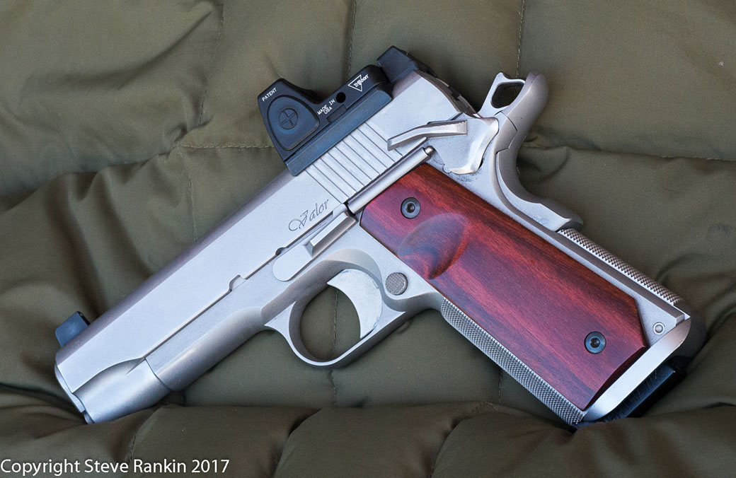

I had two Dan Wesson's machined and fitted with the Trijicon plate and RMRs; a Valor Commander in 45 and a PM-C in 9mm.
While the machine work was excellent, both guns were sluggish afterwords. They run OK on full power self-defense loads (Federal HST), NATO FMJ and +P. OTOH, both guns run poorly on lighter IDPA/USPSA handloads.
The Valor Commander 45 tends to stall when the round hits the feed ramp, and the 9mm PM-C stove pipes like crazy.
The core of the problem is the 1.4 ounce additional weight of the RMR & mount, even after machining the slide.
The Chambers mount looks to be significantly lighter than the Trijicon mount, especially if one leaves off the BUIS. Even with the BUIS, I'm sure the Chambers is lighter because the rear sight on the Trijicon mount is massive.
FWIW, my next move is to put the slides on a diet with a tri-top and carry cut.

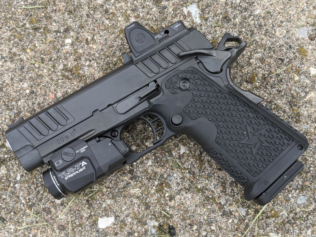

An update on this thread:
I now have a Staccato C2 with the Chambers Custom RDSM installed and an RM06 Type 2. I put maybe 250 rounds through the gun before it went to the gunsmith and maybe 300 rounds today with it back.
Here are my thoughts:
1) The Staccato C2 is an absolute rock star of a gun. I was skeptical about the way it would track through recoil with the aluminum frame (more weight is more better, right?) I was wrong. It shoots smoother and tracks faster than my Tactical 4.0 HOST (my only other STI). I think that the Gen 2 grip (in this case the ODS grip) has a lot to do with that. It's thinner and has excellent gripping surfaces.
2) The RDSM is an outstanding mount. This is my first foray into an irons forward red dot configuration. I can take or leave that part so far. The mount puts the dot pretty low and is very well made. You can tell that the tolerances are exacting. The gun shoots great with the optic installed. No shock there.
3) My only complaint with the RDSM - there has been some material out there claiming you can retain your factory height front sight with the RDSM because the rear sight is lower than a suppressor sight. The second part is true, but with my gun zeroed and shot off of a rest at 25 yards, the offset between the irons and the dot is obvious and massive. I would guess it's 16-18" high with the irons. I'll be doing some more testing and getting a taller front sight. Not a big deal, and likely amplified on my shorter slide gun.
SO... If you're looking for a red dot mount for your 1911 or 2011, I think the RDSM is a very attractive option.
Posts: 5501 | Location: Iowa | Registered: February 24, 2011Reply With QuoteReport This Post
Finally posting a photo. I have since obtained a Staccato P and had an RDSM installed on it, also. I really like the mounts. I'd say I have a couple thousand rounds on them now in total with no shift in zero or other issues. Still need to calculate the proper front sight heights but just haven't gotten to it.
I think the new C&H plate for the DUO guns looks pretty good, but you're already paying $500 extra for it plus the C&H plate where you're into the RDSM for about $350.
