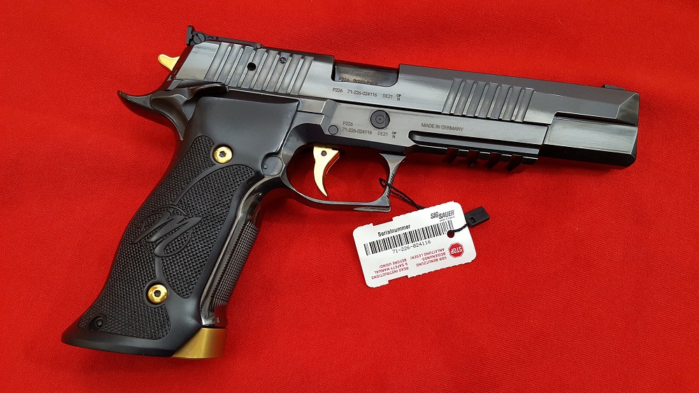

Here is one the few genuine factory made guns that were in the process of being made at the end of 2020 and spilled over into early 2021 for completion, the P226 X-SIX Midnight. And, it's in their 2020 catalog, so you know it's legit.
DE21

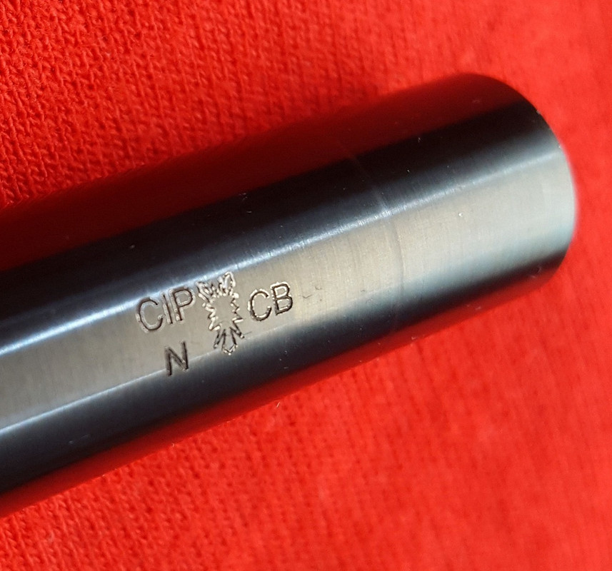

Kiel proof house symbol, CB date code (2021)
Test target done by their Head of Sales at the time, Hendrik Geissler. Near the end, you'll see A. Koch's or M. Barski's stamped signature on the test targets and they're legit. At the end, Geissler's signature was about the only one you see, as it appears that he was the only one left who did these test firings, as SIG DE was winding down.
Even a letter by Geissler

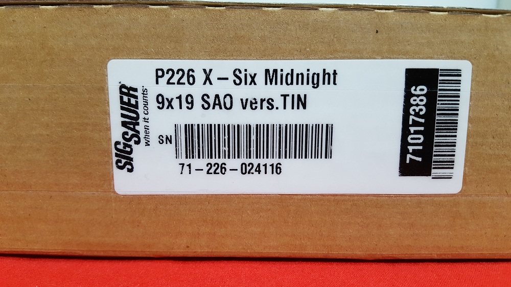

Outer cardboard box with proper label containing legit factory info on the gun

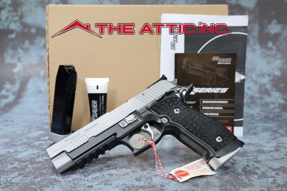

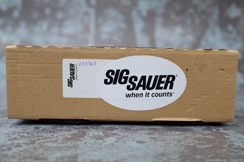

This is another FrankenSIG example done by the same German dealer, imported by none other than The Attic. No "Holden", but note the signature, the handwriting, the blank label on the outer cardboard box. Frame is German, but note that it's 2nd Gen (aka the Enhanced version) frame topped with a 1st Gen upper.
Not only did The Attic use to claim on their listings that these guns were made by SIG DE factory, but also that they were imported directly from SIG DE, which is another BS, because the German factory was still under their government exporting prohibition.
