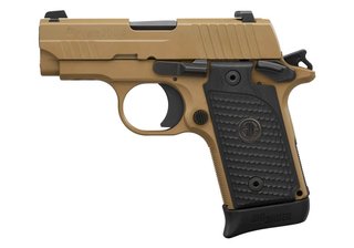

I think it makes sense. Smile In the fall, I finally purchased a P238 Emperor Scorpion when I found out they were back into production, and I love this little gun. It replaced my LCP as a backup and pocket gun, and it is demonstrably better in all respects. A micro 1911 without a grip safety, what's not to like? After 400 rds, not one single problem and it is a great shooter
